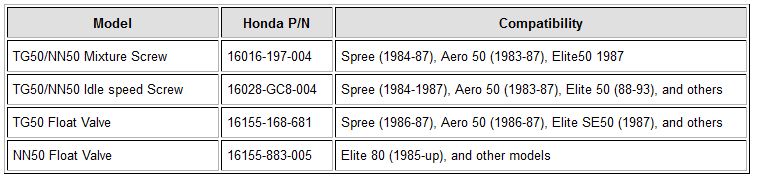

graphite9 wrote:Does anyone know where to find a stock 85 gyro air/idle screw? Mine decided to vibrate out somehow...
Cross check it against other carbs. If it is NLA, one of us will have it (we have to).

Carb parts have pretty good interchange for NN50 and TG50. Here's a few items:
Please double check p/n's before ordering, this is a new table...

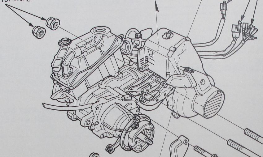

I'd say everyone will agree the US TG50 and JDM Roadfox have a powertrain which looks the same.
If we can agree the TA02 engine is found on the Gyro Canopy, here is a diagram. It would not get mistaken for a TG50 powertrain.

And yes the TA02 engine is totally different from the Gyro S

i think its interesting to see that even though the design has changed, there are still similarities hinting back to the older models. take for example the brake assembly. looks very similar to the S model. they also kept the whole principle of forced air cylinder cooling. in this case, the way they have it designed, it kinda looks like a mini turbocharger in a way.
