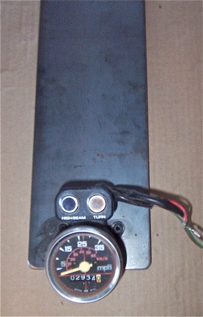

#1 get some plate steel .
#2 use your speedo as a template mark bolt holes .
#3 Drill holes cut out slot for speedo cable
#4 take your old headlight side holders do some measuring .
#5 clamp holders in position onto the plate do some tack welds
#6 remove the headlamp housing /then finish welding the side holders
#7 grind the crappy welds (Harbor Frieght cracker box welder )
#8 make a bracket to attach to the Express handlebar
#9 slap some paint on it and your good to go ...
Also like I said before I made the plate bigger so I can add switches or cig lighter down the road ...

- use your speedo as a template drill holes
- 100_1959.jpg (42.51 KiB) Viewed 7886 times

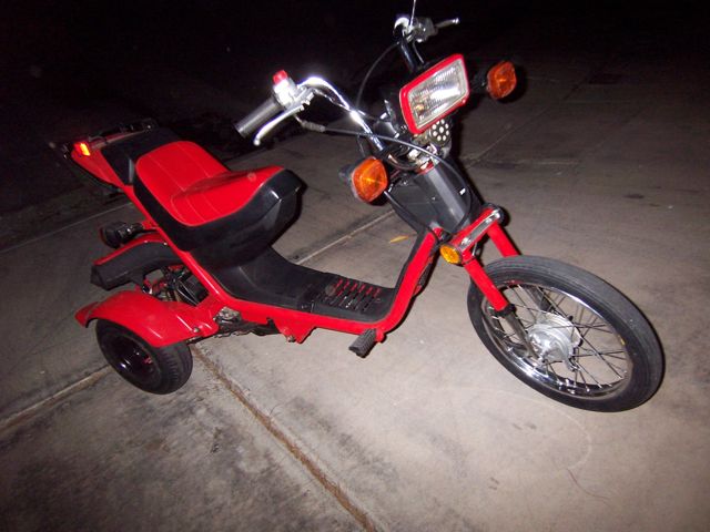

OK your almost done ...
- clamp the side holders to the plate after you get the position correct.
- 100_1969.jpg (51.84 KiB) Viewed 7886 times
- Start grinding the slag
- 100_1971.jpg (53.21 KiB) Viewed 7886 times
- slap some paint on it
- 100_1976.jpg (48.7 KiB) Viewed 7886 times
Re: Gyro - general thread
Well this should take about 2-3 hours .W/O rushing
it was actually pretty simple ...
- Notice the plate is bigger for future add ons
- 100_1988.jpg (63.07 KiB) Viewed 7885 times
- 100_1991.jpg (76.95 KiB) Viewed 7885 times
- Take your gyro for a ride
- 100_1993.jpg (50.95 KiB) Viewed 7885 times

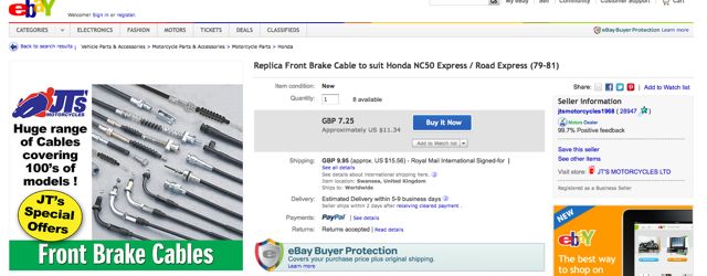

Oh 1 more problem the front break cable is bad as it has become very hard to move inside the
cable cover ... you think it's easy to get a replacement ...Think again ...
it takes the NC50 Express or PA50 hobbit cable w/ spring ...they are easy to find in U.K.
for $12.00 but another $15.00 for shipping kinda sucks ....
Anyone know where to get these cables in USA ?
I have googled the $hit out of this so let me know if you have a super secret special place for front brake cables ?

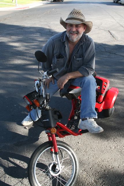

For the TG50, I've been using the easy to get Elite SA50 front cable from '94 up. Takes just a bit of grinding on the ferrule to get it to fit. It's about 2" longer, but dresses out ok on a stock TG50. Can't say for sure what's best for your customs. I've been trying to get folks to report into our cable database for the very reason of customs. Help your creative brothers like 66Six out - please measure and post cable dimensions!
BTW - Great pic of you and your new custom

Thanks Mousewheels but it is no longer a TG50 it's a NC50 Express front end & brake...
Very different .....
I have tried so many places to find this stupid cable and have designed a cable stretcher
luber and puller ...and do-dad which is not working out very well ...
As for a thing-ma-jig it's perfect but freeing up cables nope ...
I mounted a brake lever to a bar hooked the other end to two 25pound sandbags..
sprayed the $hit out of the ends with every type of lubricant I have even tried graphite ...
I work the brake lever like a pump it got a little looser then I used a pipe over the lever to get more
leverage the 50 pounds do go up and down but still no cigar ...
I'm thinking is a front brake really that useful ?
Just one more thing to fix .....
Oh buy the way I did try to use the Gyro hub & brake ....not even close ...
Up-date 5/31 / 12 went to the bike junkyard and found a cable that works $5.00 bucks ...Yeaaaa ! ! !
Everythings good .....
