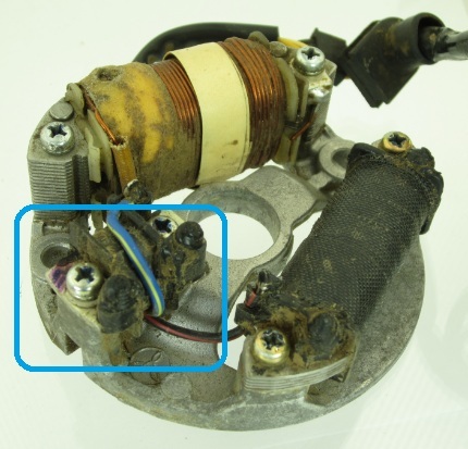

You can skip over the headlight and rectifier, your ignition is independent from those components.
With several Gyros around, do the easy stuff -
  • Swap in a known good CDI
  • Run resistance check on the stator spark exciter coil and spark trigger coils.
  • Make sure the run/stop switch and ignition On/Off wiring is not 'stuck low' (shorted to ground).
  • Aftermarket coil/cap is probably ok, but you could swap an OEM into yours, or try the aftermarket coil into another Gyro to be sure.

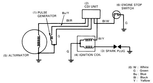

Ok - Run resistance checks in the Service Manual before buying anything... Parts swap is just a time saver.
i thought the rectifier could be it because thats what tells the cdi to fire the igition coil.
<shurg> rectifier is no where to be found in the ignition diagram (this is an Aero50, but your Gyro Service Manual will show similar connection) Coil labeld "Pulse Generator" is what triggers the spark. Its the smallest coil on the stator.

where is the pulse generator on a gyro?
Re: Gyro - general thread
Posted: Wed Oct 03, 2012 10:26 pm
gyromaniac wrote:where is the pulse generator on a gyro?
mousewheels wrote:...Coil labeled "Pulse Generator" is what triggers the spark. Its the smallest coil on the stator.

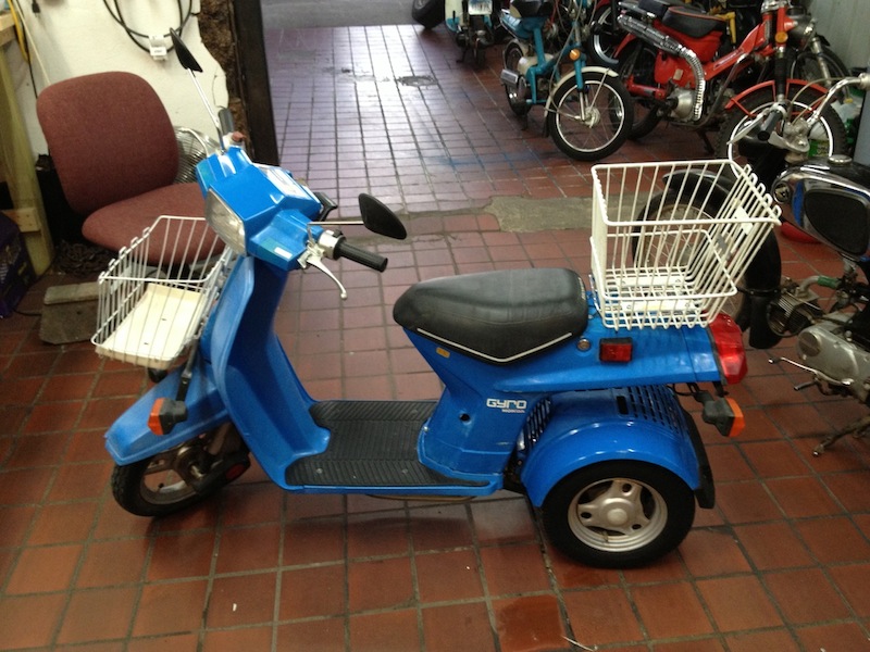

finally got mine back together. so here is the official first pic. 1984, titled, 584 miles when i bought it. tank was a little rusty, so we derusted it, lined it, cleaned the carb, new gaskets. i did put a spree basket on the back, this bike will be my shops official parts getter.
