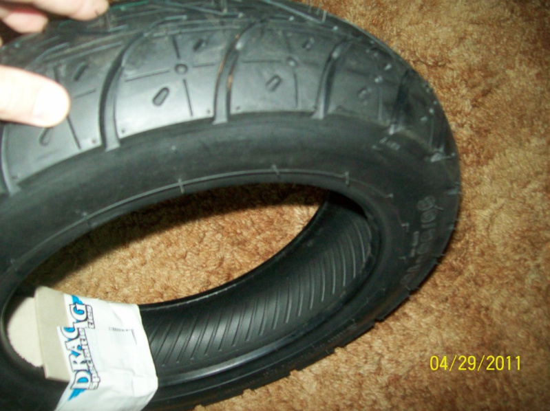

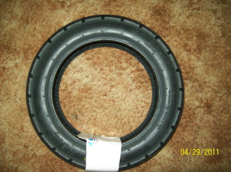

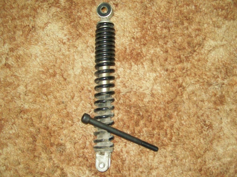

Re: Sprelite The Begining Of My Epic Build
New tire,Shock,And bolts
- updates... 002.jpg (196.52 KiB) Viewed 7953 times
- updates... 001.jpg (230.97 KiB) Viewed 7953 times
- updates... 003.jpg (158.81 KiB) Viewed 7953 times

I welded the new shock mount and the shock is like 1/8 inch from hitting the Fu@k!ng tire
time to cut it off and re-weld...
But i have to admit it did look Bad@ss when it was all together. Thanks kingjeff for the uni.

did you use any washers to space the shock out correctly?
- SpreeMadness520
- Posts: 685
- Joined: Sat Mar 12, 2011 2:21 pm
- Location: Hart Michigan
Yeah of course still didnt add much room, I didnt weld the bolt with enough thread. Good thing I bought 2

if you use the drill and weld way its alot easier if you got the right size bolt
- SpreeMadness520
- Posts: 685
I just re welded the bolt so there is more thread to keep it away from the tire, And the weld job is SEXY
