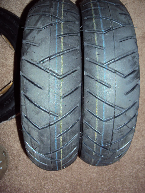

Here's is an example of why you check your merchandise upon arrival.
I ordered 2 Pirelli SL 26, size 3.50 X 10. I received ONE the right size, AND ONE size 100/90 X 10. Caught my eye when I stood these up against each other..."one of those is wider than the other", I said...Accurately eyeballin' a tape measure across the two revealed nearabouts a quarter of an inch wider on the metric size.(the circumference appears to be identical) I suspect some accidental picker actions in the warehouse. Probably wont matter in this application of Elite 80,...should be room to accomodate...If you run the numbers, the OEM 3.50's are much closer to 90/90, whereas OEM 4.00's closer to 100/90...BUT, clearly, the 90% sidewall of modern tires messiz with your sh*t.
