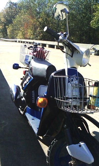

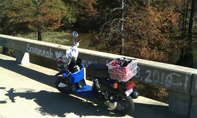

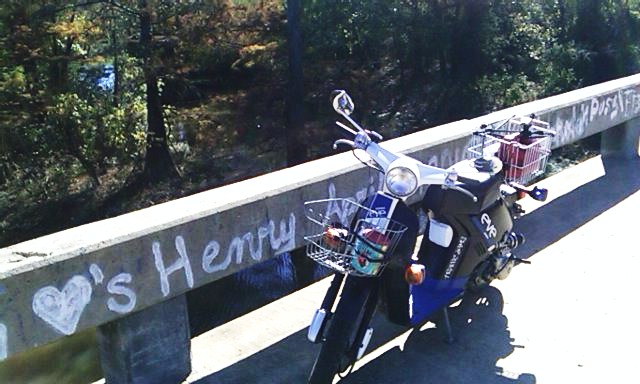

Just got home from what may be my last scoot this season. I absolutely HATE temps below 75 hahahha After about 8 miles she started bogging down then died on me so I pushed it up a hill and to this church parking lot. Took the carb off completely and changed the main jet down to a 95 from 100. I made sure everything was clean and adjusted my float a tad bit cause it still drips every so often from the vent hose. Started right up with no problems. I think the main thing is the rubber adapter becoming loose from all the rough roads around my house, it is even developing cracks in the surface already. I may have to make some type of bracket that can attach where the airbox bracket used to be to keep the carb from bouncing up and down so bad and chop a larger gap out on my side panel. Took her about 40 miles through the backwoods to my favorite fishing hole
