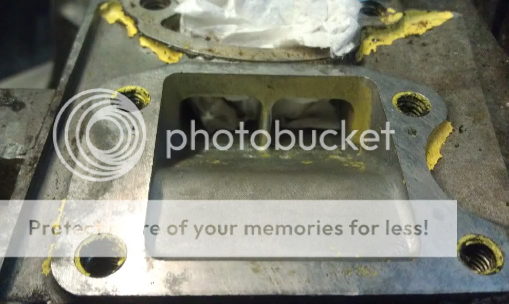

Re: Looking for Scooter Mechanic in Michigan
I took off the intake and took a picture.
It is totally stock. I will be porting an boostport matching this block. This is the before picture. :wink:
This is what it should look like :wink:
