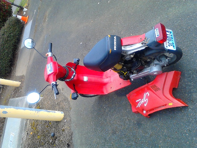

Re: Spree - Carb -o- Death
pictures
- smaller3.jpg (212.78 KiB) Viewed 5928 times
- smaller2.jpg (126.07 KiB) Viewed 5928 times
- smaller1.jpg (184.36 KiB) Viewed 5928 times
- swimmingfree
- Posts: 3065
- Location: mich.
get a hold of your welder friend and ask him to read the other post and see what he thinks...

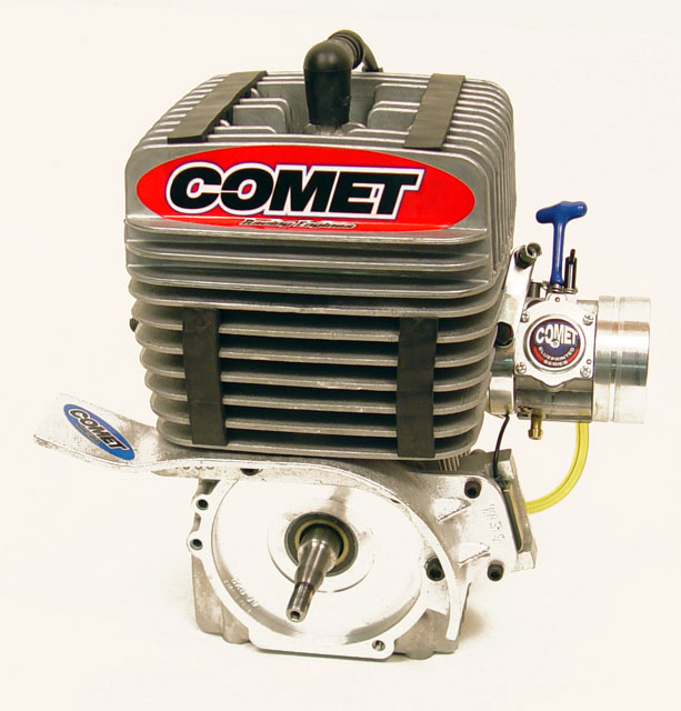

- I would love to have this 100cc
2 stroke racing motor. - cometkt100-new.jpg (70 KiB) Viewed 5925 times
- paulpauly7
- Posts: 1684
- Location: nz
thats a single speed KT100 engine they go hard i had one in a go kark lots of fun
Imagine one with a variator on my spree!
They cost a fortune though.

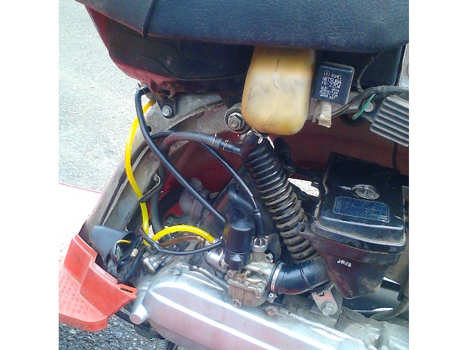

okay,
here is a link to the youtube video I made showing what my spree does.
Notice by the sound how it revv's up and then dies.
http://www.youtube.com/watch?v=thDHcQ1N ... e=youtu.be
- paulpauly7
- Posts: 1684
- Location: nz
seriously dude that sounds like a faulty spark plug or a dodgy coil pack not a carb issue
- patthesoundguy
- Posts: 3019
That air box lid isn't screwed down properly you need the right screw in it and check for the gasket. Its running lean
- patthesoundguy
- Posts: 3019
Okay I just watched the rest of that video... Dude you can't run that spree with the air box cover off like that! That is your entire problem! The oil filter being oiled does nothing if you rev it up with it not installed and the air box cover not snugged down. I'm going to sound like a broken record here but here goes, a stock spree must have the air box intact with a properly oiled filter and air box lid snugged down with its gasket intact. The air box meters the amount of air to match the amount of fuel supplied by the main jet above 1/4 to 1/2 throttle. Remove the cover or any leak in that system it runs lean and I mean lean so lean in fact it does what your spree does... rev up and die. The only way around the air box is to up jet to a 95 jet pretty much, spree comes with a 68. And even then it can be problematic.
- paulpauly7
- Posts: 1684
- Location: nz
yes lean without the airbox on but hs bike did the same withit on .Change the spark plug for a new one
Payday is monday,
and I am going to get a new plug, fresh 2 stroke
Oil, carb float, needle and seat, bystarter, fuel valve, crank seal, and a tank of chevron supreme unleaded. I checked, the air filter housing, and the gasket is missing, plus, where a gasket would go, the plastic is all warped and wavy like a snake.
