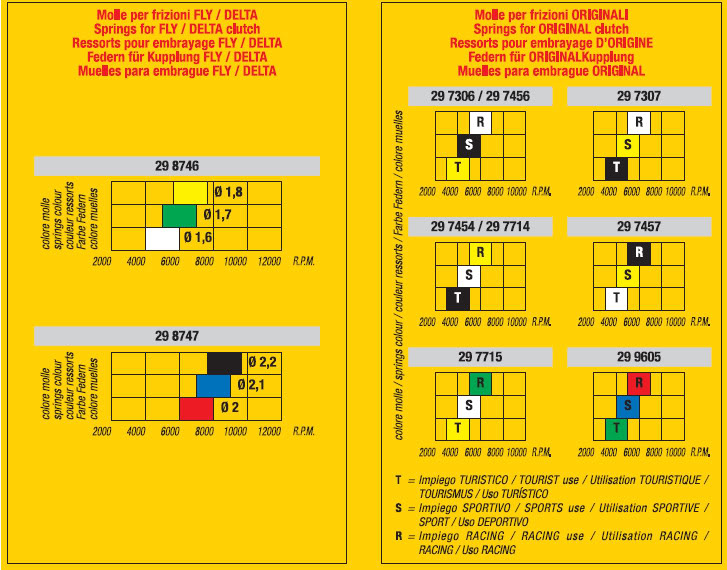

Running a Polini CP23 with a 34Pj. Funny, but after I start rolling, the 1/4 to 1/2 is responsive. Its only when I first am trying to get going after a full stop at warmed up temp.
I have the blue clutch springs installed and in accordance with the chart (springs 29 9605), it could/should engage from 4-6k rpm. I could install the red springs (engages between 5-7k rpm) to see if things change...
clutch springs.jpeg (115.88 KiB) Viewed 12195 times

Drop a pilot jet and reset your idle and see where that get you. Pilot jet is pretty much done by 1/4 throttle possibly adjust your needle clip as well if the pilot doesn't do the trick. And if 1/4 throttle to WOT is good then the rest of our settings should be good. Here is a great tunning chart. Image
