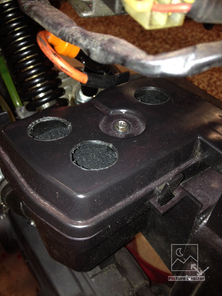

As for reporting back on tonight, made no changes to anything as I was pretty busy around the house prepping for my little guys birthday party this weekend, snapped a pic of the air box lid, and did a quick 3 mile cruise but had no chance to pull the plug. Ran great until I got down to the red on the gas gauge and started to feel like I lost some pep? No, I didn't run out of gas! But is that normal to lose a little pep with lack of pressure in the tank maybe? Or was I just imagining things because I was ready to go home a drink a beer, or 10.
So air box lid below, I tried to disperse the air flow by putting one one the side of the stock inlet and two opposite spaced as evenly as I could.
- image.jpeg (192.59 KiB) Viewed 12836 times

Hopefully that analogy explains it, and also explains a bit why I will tell you that the 3 holes you drilled in your airbox, is too much air. You want that back pressure from the air box. Cover up those 2 holes that are right beside each other, and only use the one closest to the normal inlet. If that makes it dog a bit, then uncover 1 more. 3-1" holes, is way too much air.
