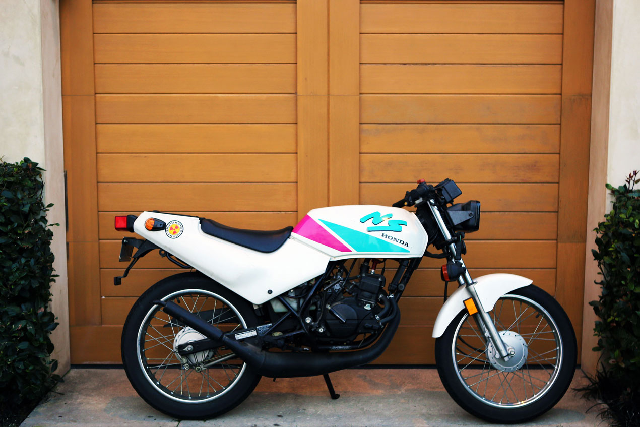

I just picked up one of these bad boys on Craigslist for $650. only has 550 miles on it but some of the decals are gone.

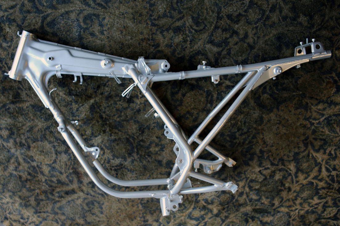

I got the frame back from the Powdercoaters. i went with a Silver color and a semi gloss clear coat. everything else on the bike will be black except for the gas tank and the mono shock spring. ill also do some Gold accents like the chain and some hardware parts. You will also notice that i chopped off the back part so i will not be running a rear storage compartment or the side panels. they are for sale if anyone would like them
This is the a picture of the frame with the swing arm in place, monoshock with the powdercoated spring to match the color on the gas tank decals. turned out nice in my humble opinion.

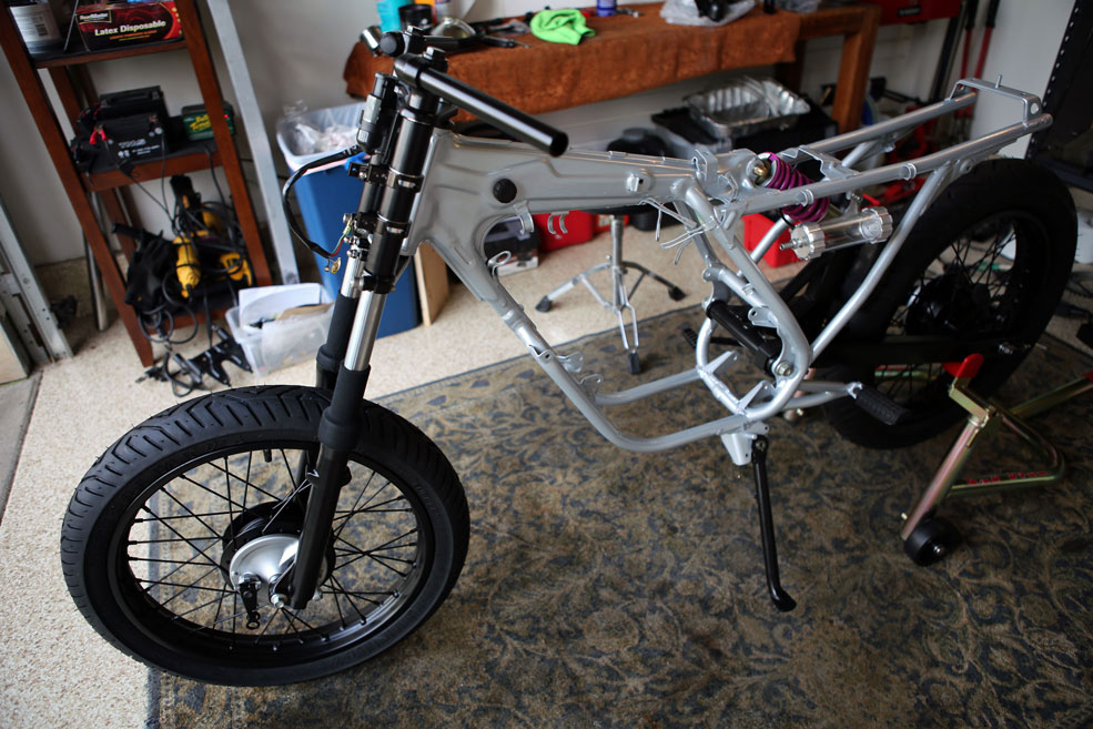

The front wheel got the same treatment as the back wheel with the 90/80 pirelli, new tube, new powdercoat, new bearings. Fully installed and ready for some quick spinning. Im going to stay with the stock speedo and brake cables but i will be upgrading the perches, levers and speedometer themselves later.
One of the more tricky things i did was change the front headlight mounts and redbuild the forks. Rebuilding the forks was easy. i got the bottom parts powder coated black and polished the tubes. the tubes are only 29mm so it was hard to find headlight brackets that are that small so what i ended up doing was buying 30mm ID tubing and cutting it to fit on the tubes between the two triple tree parts. then i was able to buy 33mm brackets that went on nicely. I also upgraded the triple tree bearings with All-balls racing tapered bearing sets #99-3516-5 on the top and #99-3517-5 on the bottom. on the top i don't use the dust seal.

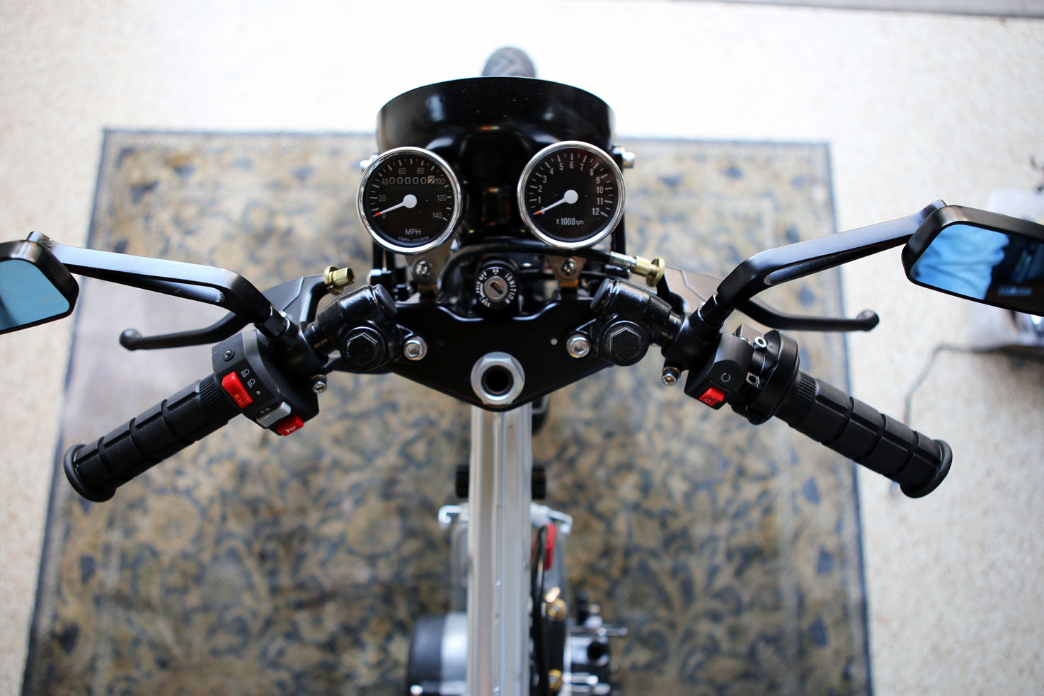

This is pretty much how the handlebars/control will be with some detail on how i mounted the speedo and the tach using the stock triple tree mounts
