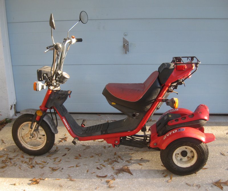

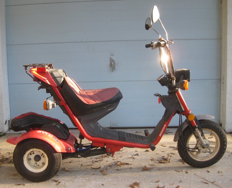

A big thanks to motormike who got me off the dime.. here are a couple of photos of the new project. I'm still looking forward to the first ride which should be a few days from now:
