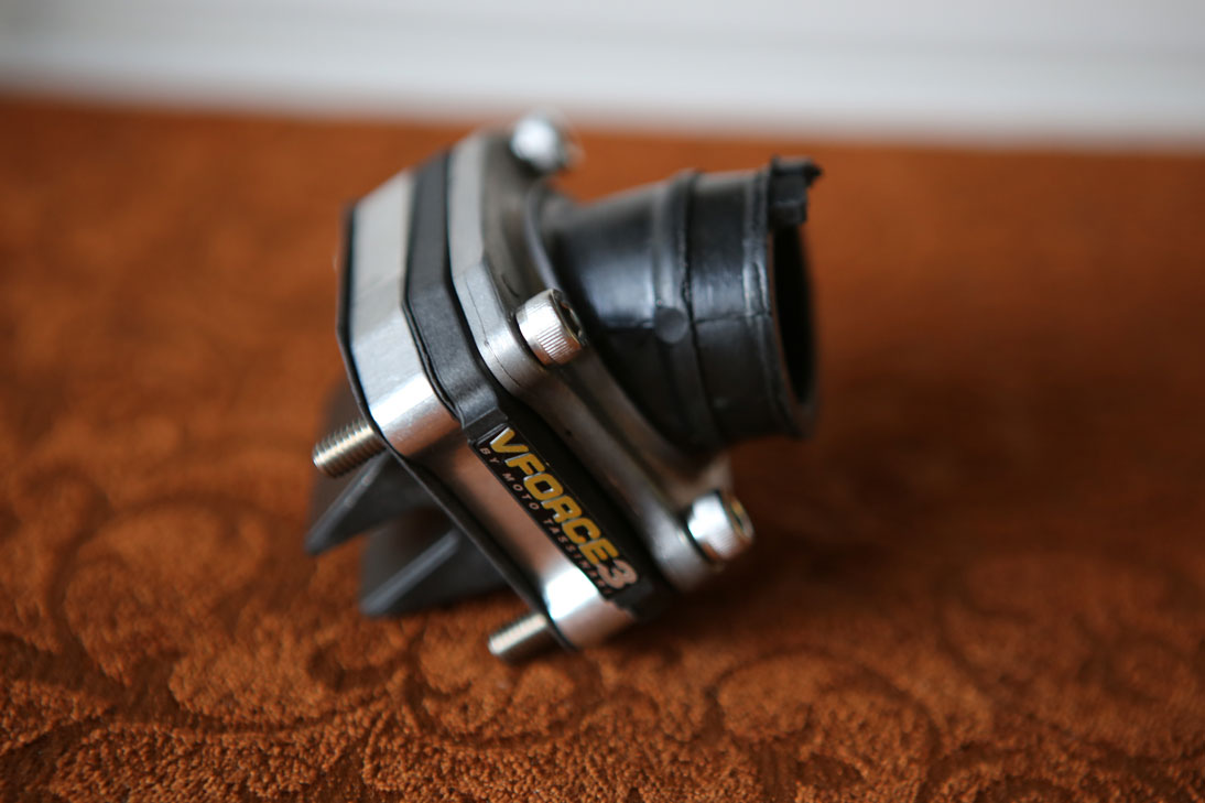

This is the V-Force Reed setup all laid out with the gaskets and hardware and then put together. CR80 intake with a brand new seal
sexy time! :love:

Thats killer, I am enjoying this. I have another 25 days till I get my corsa and intake and stuff.

spiro wrote:This is the V-Force Reed setup all laid out with the gaskets and hardware and then put together. CR80 intake with a brand new seal
i dont even want to post pics of my rebuild after seeing yours!
so what model# vforce is that?
do us a favor when you get to wiring, lots of pics and diagrams ?
