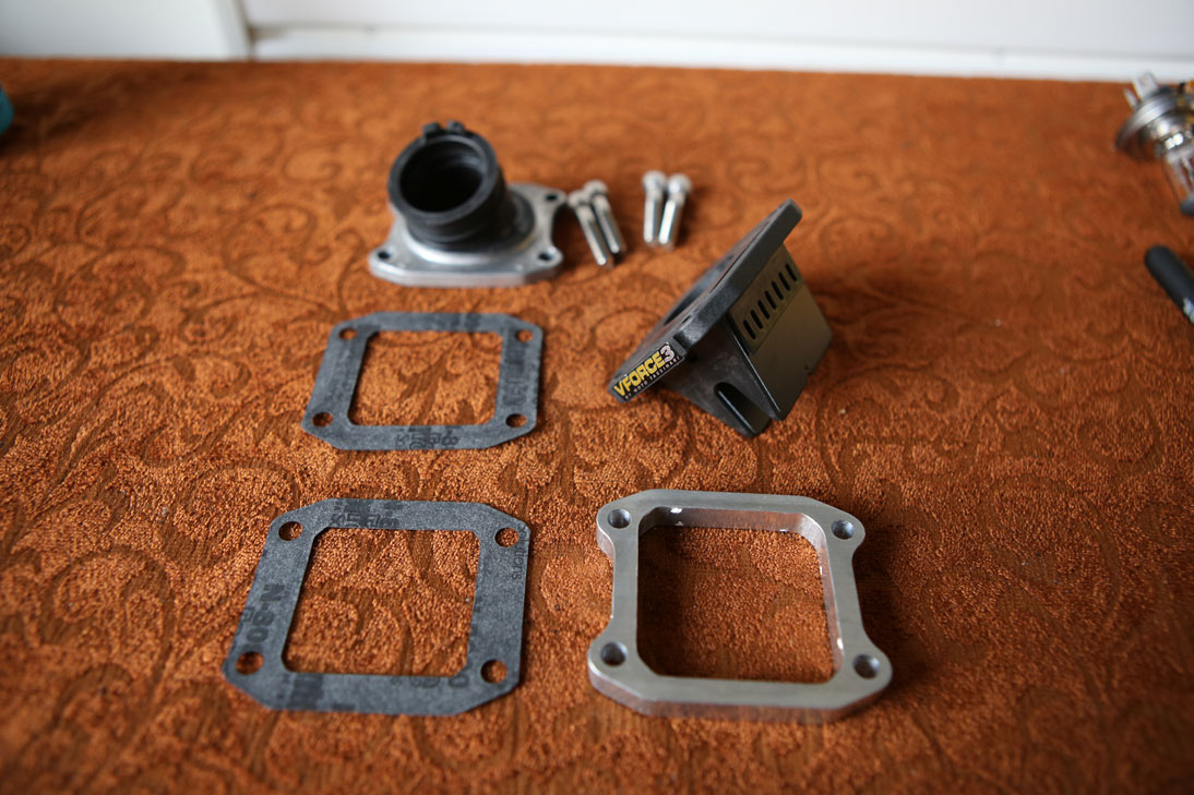

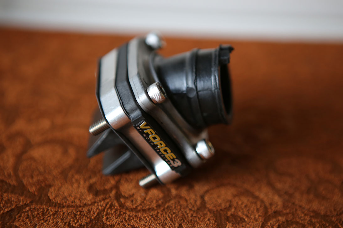

This is the V-Force Reed setup all laid out with the gaskets and hardware and then put together. CR80 intake with a brand new seal
sexy time! :love:

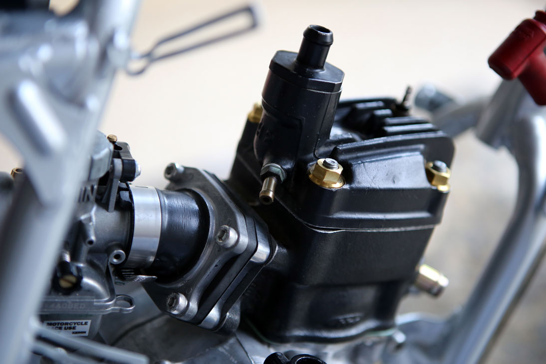

This is the top end all put together with the intake and the PE24 carb in place. i am running a 35 pilot and a 90 main for the jetting. thats what i use on my 46cc goped so i am hoping its close. im hooking up the radiator tonight and installing the carb cable so i will have some cool pictures coming up. i bought these really cool aftermarket racing radiator tubes online that are blue, i think they will give the cooling system a good look. Im also running an intake tube to the carb with a UNI filter. i find that having some length to the carb from the air filter really helps with tuning especially on 2-stroke. putting a pod filter directly on to the carb gives it a sputtering mid range on all my old projects.
more to come!

Looks factory and from your photos looks studio. Good work so far keep it up oh and get me pictures of the spiderman! Haha
When you first start it can we get a video??? Pretty please!!!

spiro wrote:This is the V-Force Reed setup all laid out with the gaskets and hardware and then put together. CR80 intake with a brand new seal
i dont even want to post pics of my rebuild after seeing yours!
so what model# vforce is that?
do us a favor when you get to wiring, lots of pics and diagrams ?

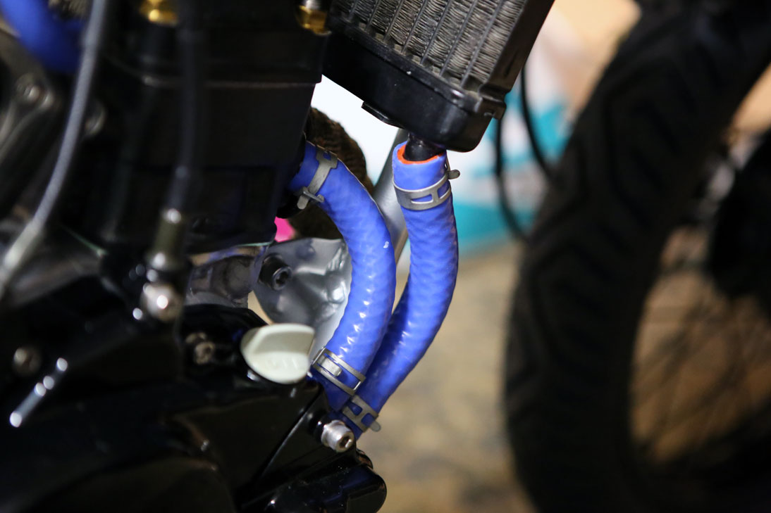

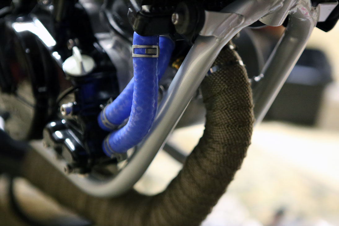

So I got the radiator in place. I had to use the original radiator because its pretty difficult to find new ones and I am not aware of any radiator upgrades that easily fit into place. The radiator I have is in good shape actually, the black paint looks nice and the cap is in good shape. I ordered these radiator tubes on eBay and they fit in place nicely. They don't match the blue/green decal on the gas tank but I still think it looks better than the stock black hose.
the second photo is the radiator hose with the exhaust on also. I did a titanium wrap over a black high heat powder coat.
