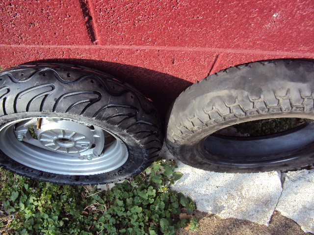

uhm. wow. yup, you really did need some new treads.
Someone really got their mileage worth on the one that you replaced
or did quite a bit of burnouts :mrgreen:

It's gonna feel good to be on new rubber. That one reminds me of some of the tires I had on my old '63 Impala during college days. I pulled into a service station once (yup, one of those full service varieties) and the guy told me he could see the air through em.

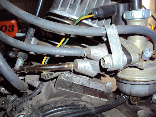

The stock intake has 2 inlets: 1 for oil, 1 for petcock

The CT intake has 1 inlet

The answer is 2 bucks at the hobby store. Fittings for R/C planes or cars fuel-powered.

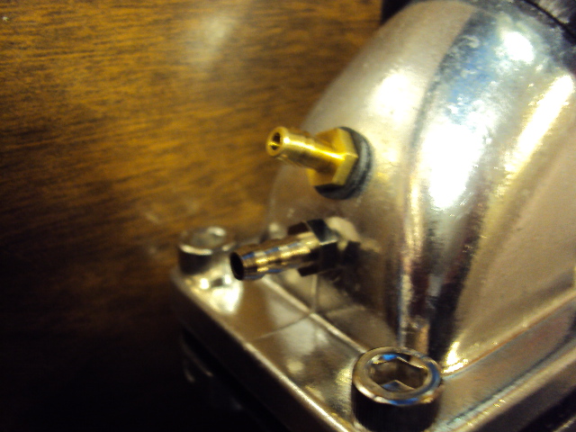

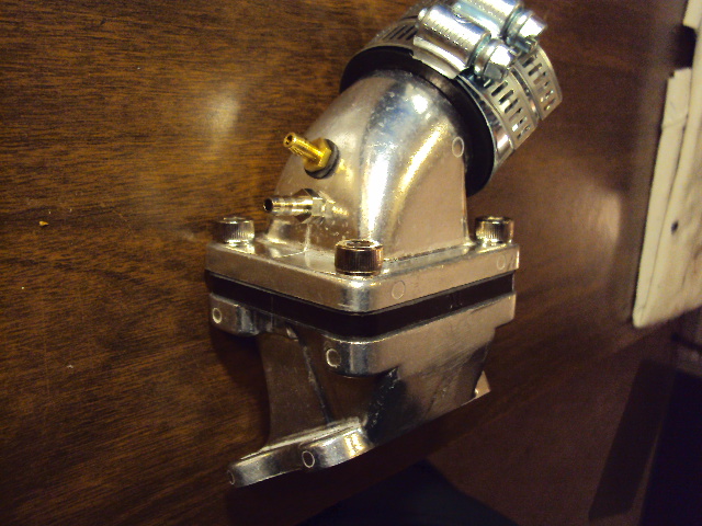

Result....Yes, I will continue using the oil pump. The man who drilled and tapped the intake has been racing motorcycles for 50 years and he said that the pump should be putting enough in the mix without adding any to the tank. I'm not sure I agree with that, but I find it difficult to question his opinion. The option of pre-mixing a small percentage remains..... :thumbwink:
Intake Inlets 001.JPG (165.18 KiB) Viewed 15252 times
Intake Inlets 003.JPG (167.2 KiB) Viewed 15252 times
For added resistance to vibratory influences, each inlet has been sealed with Red Loctite.

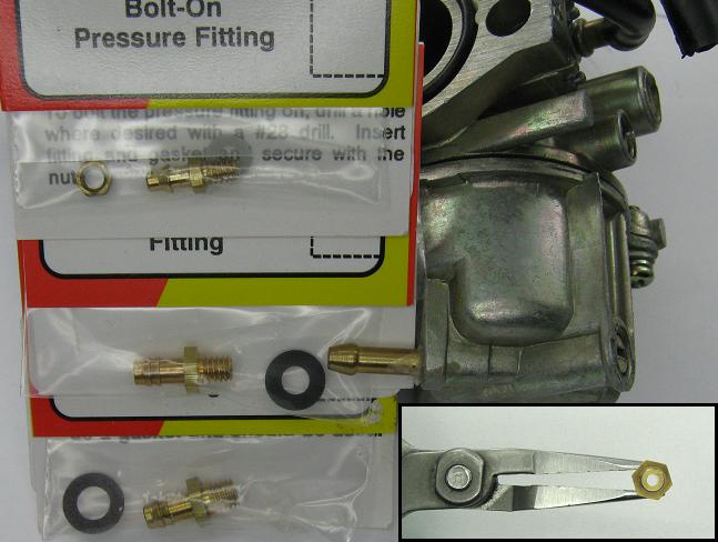

If I may for information sake:
The Du-Bro pressure fittings are english thread. You can drill/tap for 6-32, 8-32 or 10-32 depending upon which size is purchased. For a vac tap, all sizes would work, but larger than 6-32 is more robust. Drill size and taps for the pressure fitting is in the 'wiki at http://hondaspree.net/wiki/index.php5?t ... acuum_Taps
