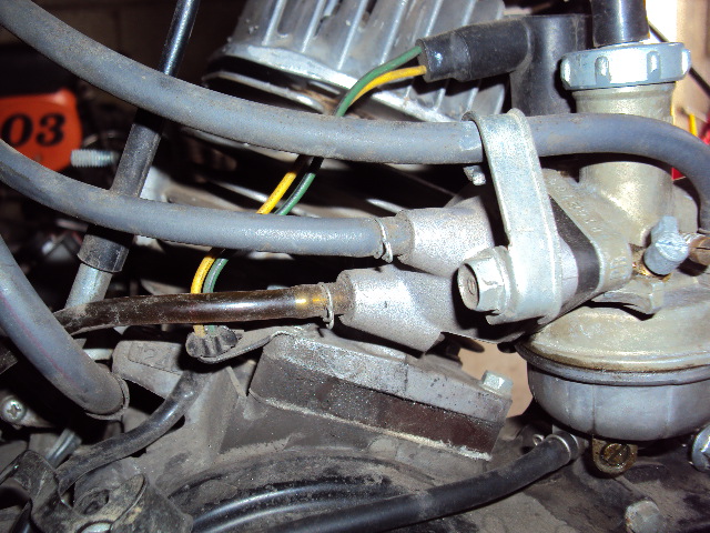

The stock intake has 2 inlets: 1 for oil, 1 for petcock
Aero 125 repairs 007.JPG (170.99 KiB) Viewed 15288 times
The CT intake has 1 inlet

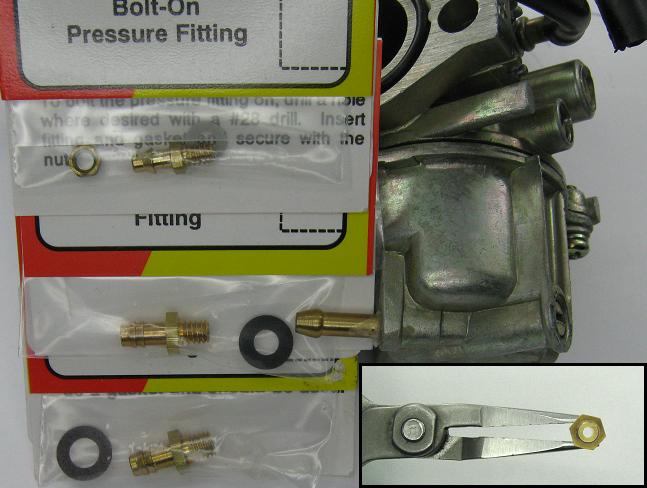

The answer is 2 bucks at the hobby store. Fittings for R/C planes or cars fuel-powered.

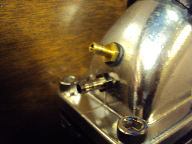

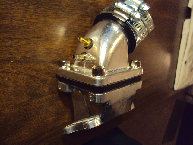

Result....Yes, I will continue using the oil pump. The man who drilled and tapped the intake has been racing motorcycles for 50 years and he said that the pump should be putting enough in the mix without adding any to the tank. I'm not sure I agree with that, but I find it difficult to question his opinion. The option of pre-mixing a small percentage remains..... :thumbwink:
Intake Inlets 001.JPG (165.18 KiB) Viewed 15266 times
Intake Inlets 003.JPG (167.2 KiB) Viewed 15266 times
For added resistance to vibratory influences, each inlet has been sealed with Red Loctite.

If I may for information sake:
The Du-Bro pressure fittings are english thread. You can drill/tap for 6-32, 8-32 or 10-32 depending upon which size is purchased. For a vac tap, all sizes would work, but larger than 6-32 is more robust. Drill size and taps for the pressure fitting is in the 'wiki at http://hondaspree.net/wiki/index.php5?t ... acuum_Taps
