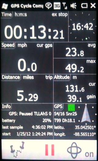

gps :D

Is that an app?

yup for my windows powered HTC tilt2 :D it will map your ride with google maps and some more stuff but I just use it for the gps

What's the name of the app? Is it pretty reliable and accurate?
Ps, I think your battery is low. ;)
