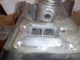

new to me motor. got it free
new motor.jpg (43.99 KiB) Viewed 6100 times

would it do me any good to do any intake porting while i got it off?
Mystic
Posts: 2140
Location: Guys, Tennessee
Re: soft seize?
Post by Mystic »
You would need to split the cases if you are going to port the intake cause the shavings get everywhere and you dont want that stuff inside the crankcase when you run the motor cause it can score the piston and cylinder walls

Mystic wrote:You would need to split the cases if you are going to port the intake cause the shavings get everywhere and you dont want that stuff inside the crankcase when you run the motor cause it can score the piston and cylinder walls
yeah, that's why i was wondering if it would be worth it to do.
