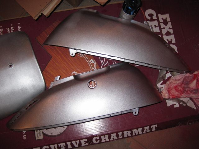

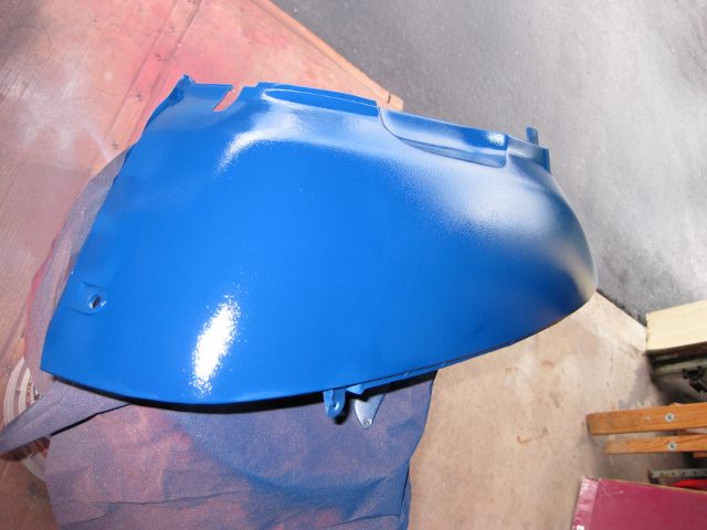

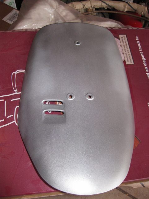

Some updates on my spree .

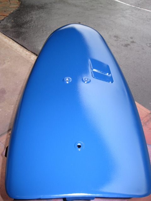

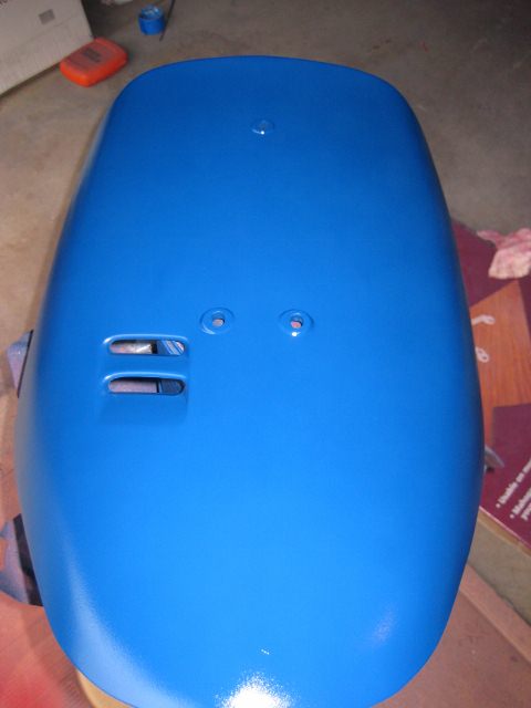

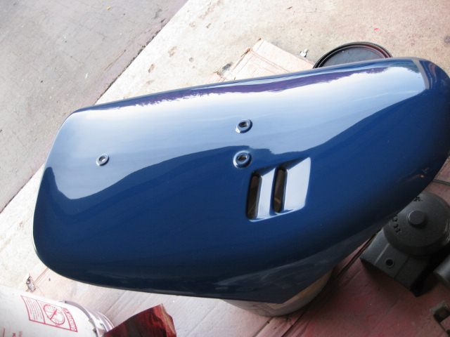

Yesterday I got most of my spree panels paint with Rustorleum Enamel paint.Did a pretty good job. I am waiting to apply the Clear coat may be Saturday . Want to give it time to dry.After clear coat . I am going to let it sit before I can sand and polish .

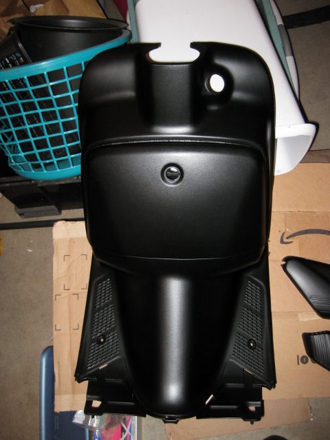

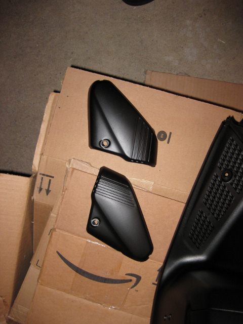

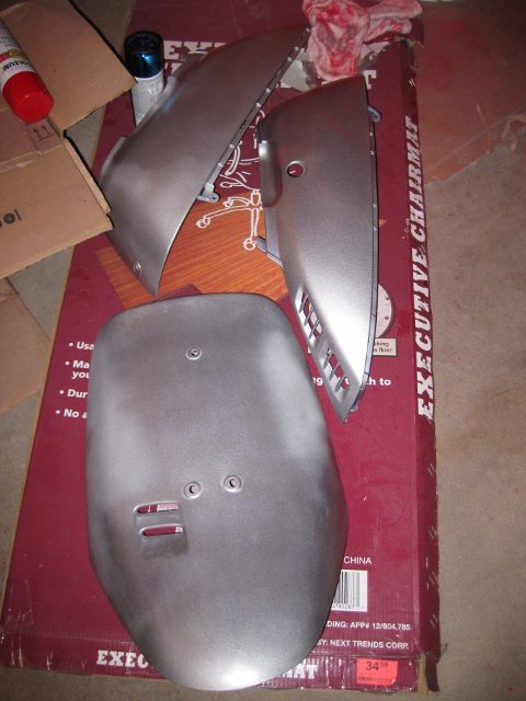

Check this out Bonesv I used the kind or paint that you required to me on my elite . Man those parts look so beautiful.

Duke250 wrote:Check this out Bonesv I used the kind or paint that you required to me on my elite . Man those parts look so beautiful.
like the satin black!
what exactly did you do and use please?
(I will be painting my aero in rat rod fashion and want a satin or flat black color)

Man, those look great! Yea, there's alot to be said for that paint. It's the hot ticket!
You did a real nice job.
Keep posting the results for us on the rest of it.

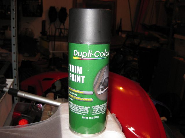

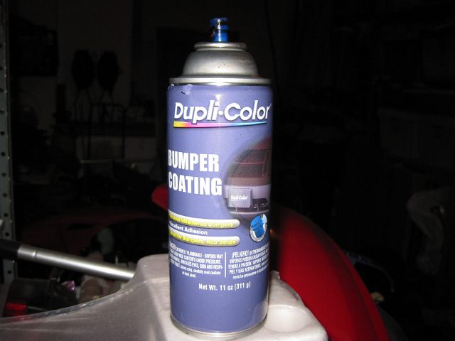

i used the duplicolor trim paint to prime it and then the bumper coat for my finish. Also they are flat black color no gloss in them . You can get those paint at an Auto parts store. Just apply those paints like the instruction say and it will come out nice with no runs.

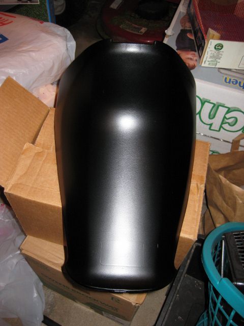

have some updates on my Elite. I had all my plastic painted that satin black and now today I got most of my panels done too. Now I've used Duplicolor on my Honda elite and Rustorleum on Spree. I did that because i want to compare both together. Now I found out that Rustorleum if you take your time it can get the job done but take a long time to dry. By the time it is taking to dry it easy for anything to damage your work. Now with Duplicolor that thing dry so quick and buy the time something will go wrong with it . Duplicolor will be on its way to dry . Now with the can I like the way the duplicolor paint shoot the paint . It is easy to apply then rustorleum paint . Those are what my panels look like . I haven't apply the clear coat yet.

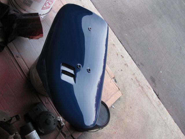

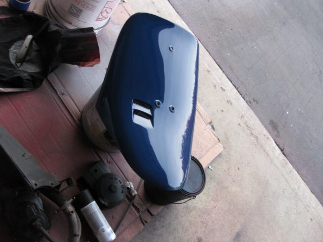

now the transparent coat.
- IMG_1974 (640x480).jpg (65.65 KiB) Viewed 5367 times
- IMG_1960 (480x640).jpg (49.48 KiB) Viewed 5367 times
- IMG_1956 (480x640).jpg (56.69 KiB) Viewed 5367 times
all most satisfied !!!!!
one down still have three to go . I haven't applied the wax yet
