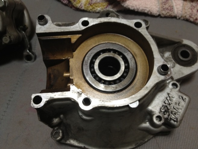

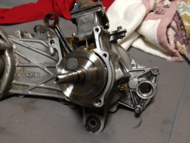

My biggest concern at the moment is how to get the Bering out of the case and how to get the crank out of the case. I've smacked it with a rubber mallet and it would not budge( don't care if I break the crank as I'm replacing it but don't want to damage the case. See photos

And the crank.

dv/dt
Posts: 137
Joined: Thu Jul 15, 2010 12:18 am
Re: Sym dd50 build!!
Post by dv/dt »
Well, the obvious answer is to get it pressed out for 5 bucks somewhere.
OR
http://www.rockymountainatvmc.com/p/44/ ... -Separator
2000 Elite: oko 24 (45/135), corsa, pg short, keli vari, 8.44 secondaries = 71mph gps
1995 Jog
2004 Malaguti F15
2007 Ducati Monster S4r
Madman
Posts: 261
Location: Japan
Sym dd50 build!!
Post by Madman »
Thanks I'll either take it someplace and get it done of make something like that to do it I guess but it won't help with the stuck bearing!!
