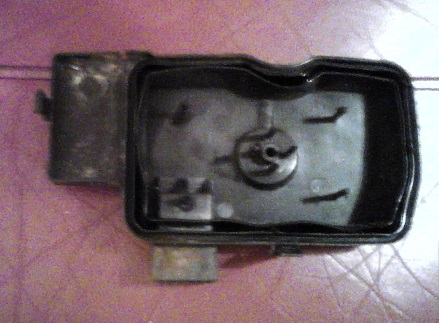

Post a pic of the lid if you can let us have a look, maybe its not that bad. If you dig back a couple of years in my posts, you will find a thread on how I augmented my air box lid gasket, with peel and stick foam. I bet if you go get the proper gasket ordered the lid will work with the proper screwlrawhead wrote:Last summer the guy let me ride it.

I will take picture of lid in the morning and post it.
Re: Spree - Carb -o- Death
Here is the picture of the air cleaner housing lid.

Hard to tell from top down but it looks fine to me.
