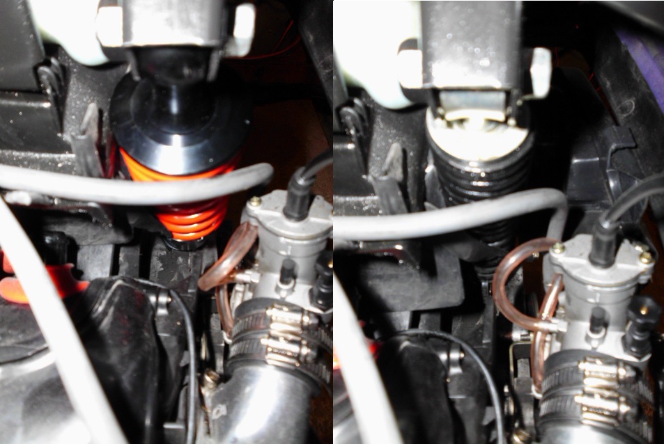

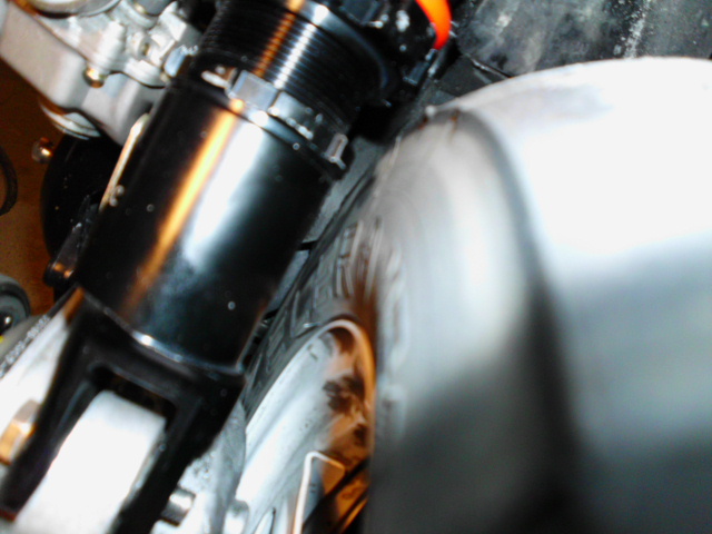

Motoritec shock compaired to stock shock
fits with stock wheels & tires
to cold out for a good ride 33deg f
but a short ride felt a lot better
don't think it will fit with metropolitan tires and wheels
but will find that out at a later date
adjustable 270 to 290 mm long
adjustable 10.629 10-5/8 to 11.496 11-1/2 long
about .250 1/4 inch 6.35mm clearance

Use a shock extender for that shock with a met rim and 90/90 and youll be fine.

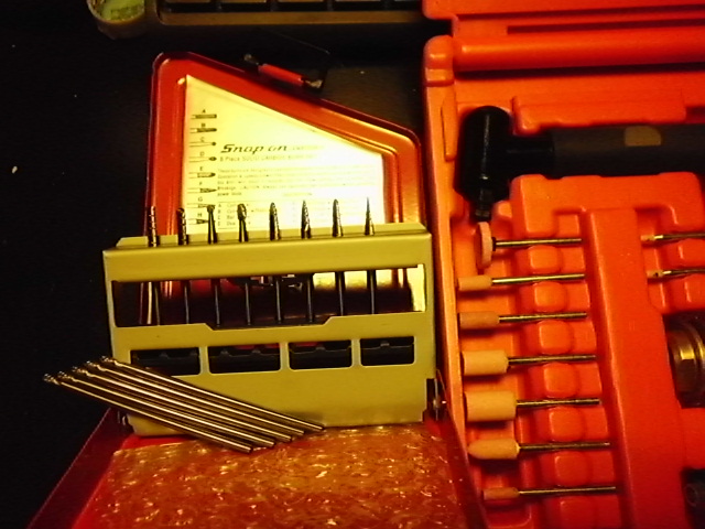

new porting tools
90┬░ Angle Head Pencil Die Grinder 70,000 rpm
and some 1/8 carbide bits some 3 in long
will come in handy for the next build I am helping on
is it summer yet LOL

Its always fun porting. Get you some junk cylinders to go to town on. I find if you start with tiny cylinders it makes you very accurate as not alot of room to maneuver. How much was your kit and whered you get it for those who dont have one yet.

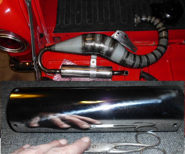

Christmas came early for me my new pipe came in
here are some pics of the arrow replica and my pg short
if we didn't have 6 inches of snow Saturday ( roads are a mess )
and 2 more inches tonight
or I would take it for a rest ride
but it sounds great and revs a lot faster so we will see
where is the good weather at because it is not in mighigan

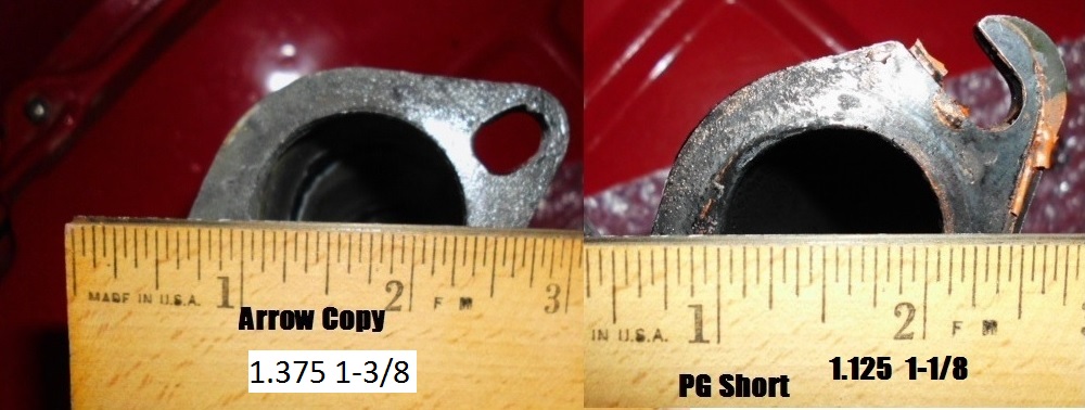

Arrow replica PG short
PG short 5lbs 0 ozs
arrow 4lbs 14 ounces
side by side.jpg (155.05 KiB) Viewed 11326 times
size comparison oops 1.375 1-3/8 arrow
fix picture 1.375 the ruler is on a slight angle in picture
just like the PG short the flange needed to be filed flat
LoveMyHonda wrote:Its always fun porting. Get you some junk cylinders to go to town on. I find if you start with tiny cylinders it makes you very accurate as not alot of room to maneuver. How much was your kit and whered you get it for those who dont have one yet.
got lucky bought the 90 deg Pencil grinder used off craigslist 120.00 (new$219.99) < dose not look used
you can buy straight pencil grinders for as low as $20.00 shipped (ebay)I used a straight one on this build
the burrs bought on ebay

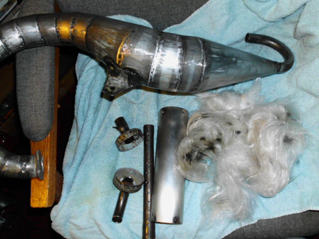

you will notice it is somewhat shiner
prepping it for hi temp coating
and started to polish or brush finish the muffler canister
well see what it comes out looking like
so what does the arrow pipe look like torn apart ready for hi temp coating ??
shouldn't hurt anything
but since it is torn apart and getting coated also
might as well de burr the inside of muffler pipe
To be continued

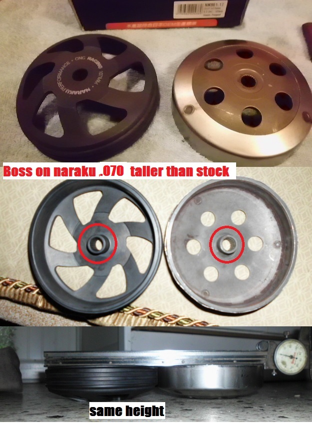

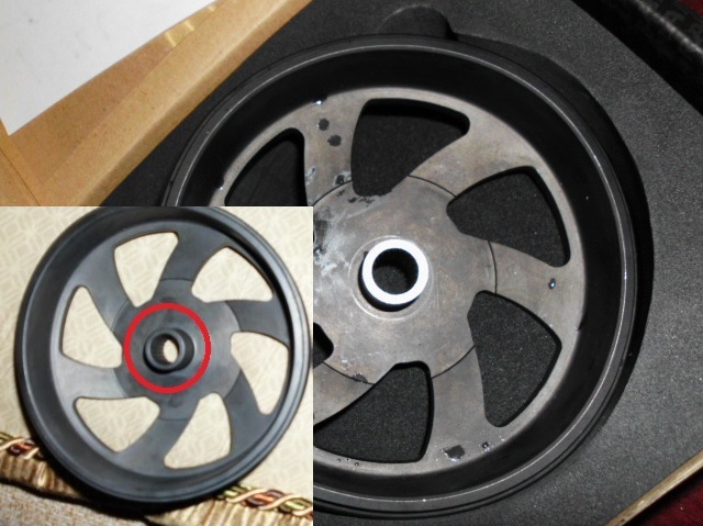

I have been trying to find a 1 piece clutch bell will fit ?
So here is what I came up with
here is a naraku NK901.17 which is 22 splines same as af16
the inside diameter 107mm bolth
the outside diameter stock 4.550 inch, Naraku 4.680 inch it has the cooling fins
overall height 1.345 inch both stock & Naraku
the surface in the bell
the surface the clutch grabs on from edge to start of radius ( the flat part only)
.770 in Nakaru and stock
now for the diffrence
the center boss measured from bolt side to inside
Nakaru .750 inch
stock .685 inch
the center boss full spline measured from bolt side to inside
stock .550 inch
Naraku .620 inch
so time to mill and drill .070 inch off boss
<- your results may very will edit later with exact measurement I take off
EDIT added info

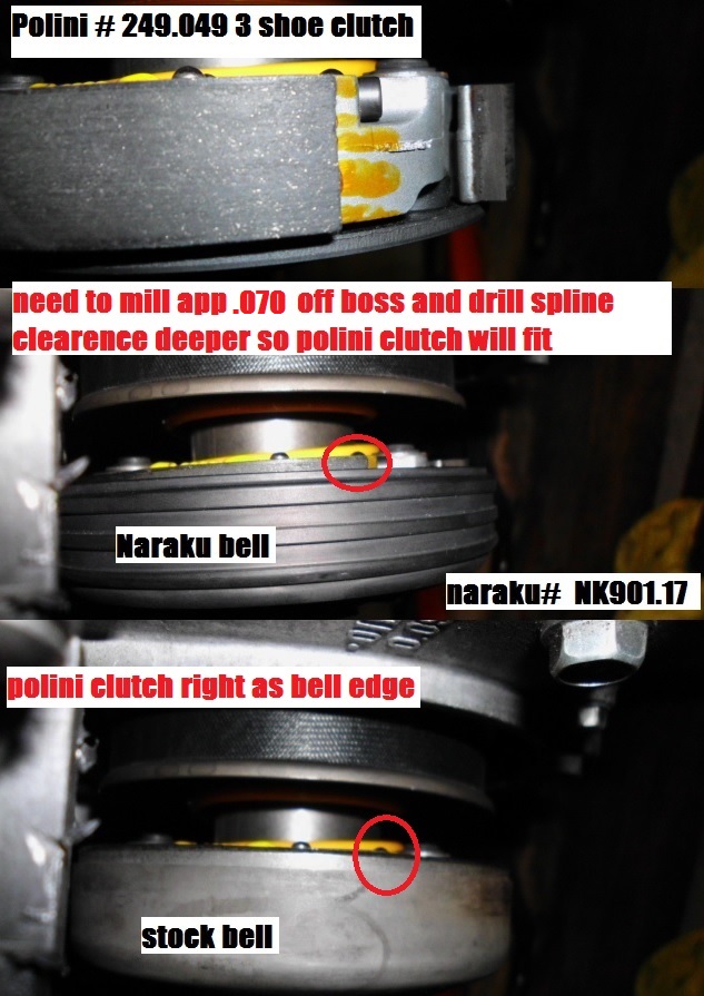

width of polini clutch shoes .700 inch
the flat of clutch bell it grabs on .770 inch stock and naraku
width of stock clutch shoes app .500 inch
EDIT
more clutch info
stock clutch shoes1.85 long x .5 wide times 3 shoes equals 2.755 SQ inches of contact area
polini clutch shoes 3.2 long x .7 wide times 3 shoes equals 6.72 SQ inches of contact area
so you also gain 3.967 SQ inches of clutch contact area with the polini clutch
culucb bell clutch.jpg (167.33 KiB) Viewed 11316 times
bell height.jpg (164.52 KiB) Viewed 11316 times
the naraku clutch bell pn NK901.17 is advertised as fitting
clutch bell Naraku V.2 CNC 107mm for Piaggio, Peugeot, Kymco, SYM, GY6
Last edited by cruzingratiot on Sat Dec 21, 2013 9:17 pm, edited 3 times in total.

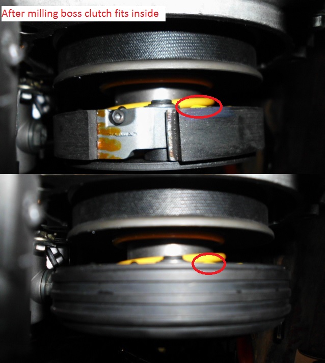

your measurements may very
decided to finish this today
was shooting for .080 of a inch ( even though I measured it as .070)
but wound up milling .100 thousand of a inch
wouldn't take any more than that it
is within .020 of hitting the big threads on clutch (contra spring ) assembly
upon further investigation I realized
that I didn't need to drill out the relief on the splines
hopefully my posts on this build will help others
that is why I try to get into detailed explanations of what I am doing
along with helping me out because the older I get the more I forget

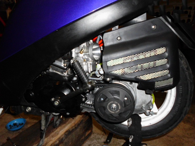

yea I know I have the filter tube from carb to air box off
I took the carb off to replace fuel lines
the 13 year old fuel lines were starting to scare me
this picture just to show you what the finished job looks like on the Elite

hi temp coating done
even made a polished stainless strap for the muffler
to replace the alloy one
