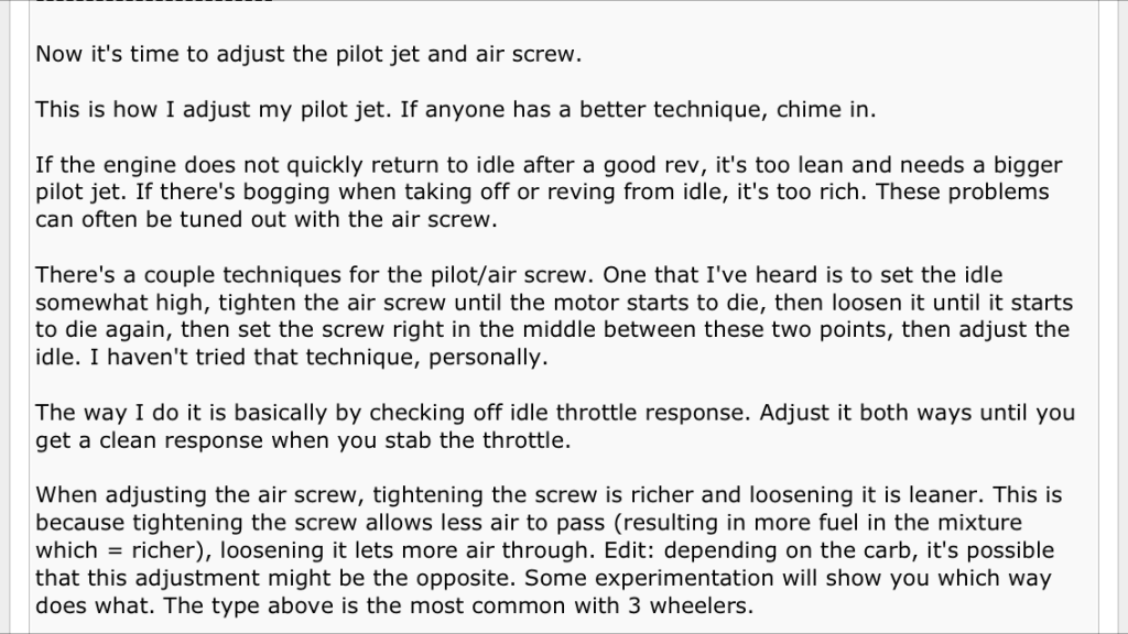

took her out for a spin today Im currently running a 38 slow and 104 main. think the 104 might be a bit lean. screams on flats and temps stay about 370 but on any sustained hill pull the temps jump up so I am gonna throw the 106 back in and see how that goes. having some issues at idle right now and not sure what my next step will be. idles but wont stay at idle unless its up to running temp. and when I hit the throttle after sitting at idle it wants to bog down i have to feather it to get the rpms up and once I do its fine. also when coming back down to idle it seems to hold the rpms up for a few secs before settling back into idle. if anyone has any thoughts let me know im still new at tuning these beasts. other than that the Corsa is a beast and hauls * even with the R1 pipe on it. the pipe seems to be a great midrange pipe but dont think it has the top end. G9 lent me a Bmoom pipe to try out so I think I might throw that on and see how it goes.
