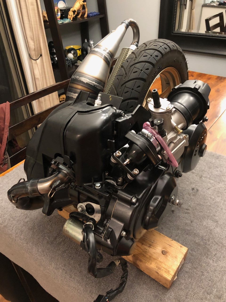

Some part are here, top end should be here this week.

So fresh and so clean
Re: Just another AF16 Spree Swap
Posted: Thu Dec 06, 2018 7:47 pm
by Wheelman-111
A most sanitary and well-executed build, well-done.
Word of Caution: The black cup on that air filter quiets the intake moan but is extremely restrictive in my experience. Well-tuned for an open foam filter, my Fabrizi would barely run when that cap went on. Probably needs 3 or more jet sizes Down, with commensurate decrease in power, if you install it.

Will the filter be unrestricted/plenty of air if I take the cover off?

If it's like the filter I had, there should be a foam cylinder under the cap - like a UNI. In that case there's almost no restriction - AND no sound dampening. The roar from the left side can compete with the exhaust racket.

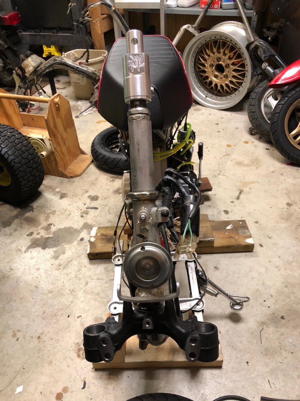

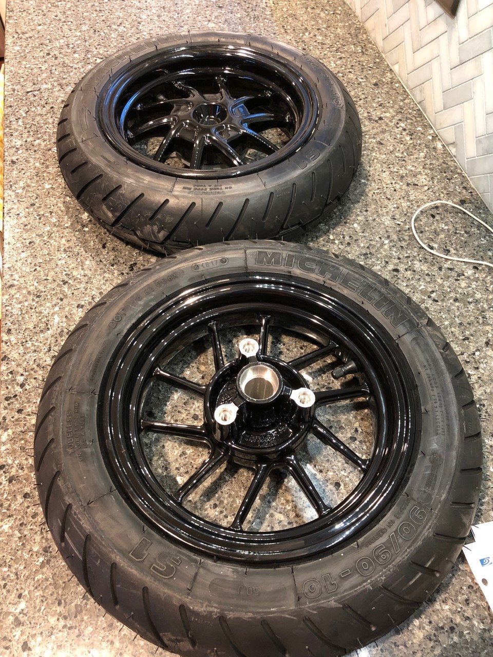

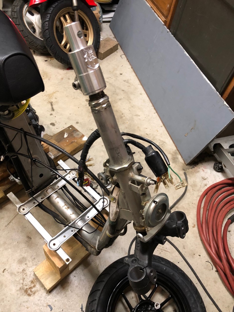

It has been some time but I am still working on the spree. I did get to take it for a short ride up and down the street but am still in the breaking in process.
Without many projects this winter I decided to continue working on the spree. Next step is/was larger wheels with a nice tires and a front rotor brake. I ended up going with a metro stem and NCY wheels with 90/90 S1’s. The rest still needs to get on order but this is where I am at. Big thanks to the Scooter Swap Shop for great info and helping with tons of questions.
