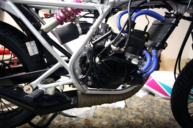

Here is sort of a completed image of the entire engine set up with tubing, cables, new hardware and carb all in place. I really just need to finalize the wiring, add liquids and see how close my jetting is. i think Im running a 35 and a 90 on the jets so i hope that is somewhat close.

Honda would be proud of this build.

awesome, thanks for the link to the plugs
That radiator though! Make a nice little grate to cover it up, a black painted screen (such as a gutter one) from a hardware store wont restrict airflow, will be clean and crisp to follow the rest of the bike and it'll add protection to the radiator fins
i'm sure you've got a shop manual, but let me know if you need the original wiring scheme. i'd be happy to scan it for you (or anyone).
i'm psyched to see your build finishing! i just picked up a 1990 honda vtr250 (cosmetically rough, mechanically great) and so now i can finally tear apart my ns50 for a rebuild. plan is to the ride the vtr while the ns is apart, then ride the ns so i can rebuild the vtr
