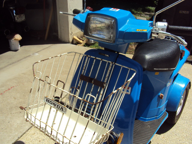

Re: Gyro - general thread
Hello vintagegarage ...[wave]

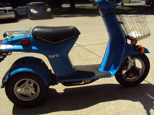

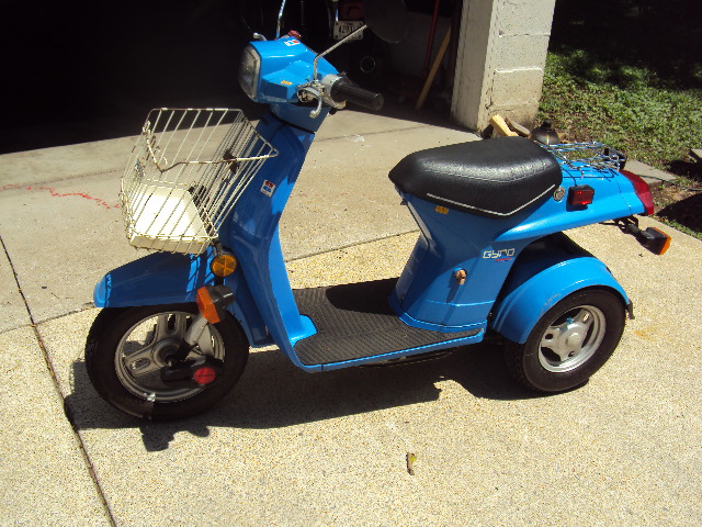

Got a tip today about an '84 Gyro...blue.
Bought it...no pix yet.
It is properly basketized already.
My girlfriend put 7 miles on it today in the church parking lot.
This Gyro is missing nothing as far as i can see.
Watch this thread for pix....seeya Vaughn....mm

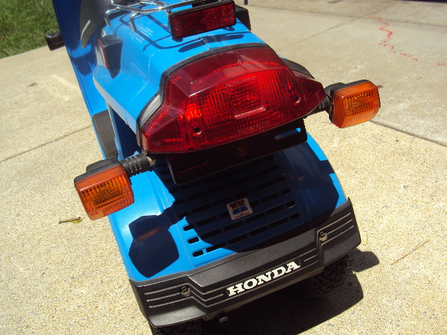

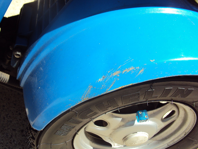

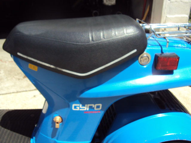

Hiya harleyracer59...
You will see in the pix that the rear bumper is fully intact on mine.
Had a friend , Joe, come over and we took both my gyros out for a spin.
After 6-7 miles WOT, the rubber vents were smoking and they cover was
soft and melted at the very top center of the vents. Even the carb access panel is mis-shapened a bit now.
Too bad it happened, but I suspect Honda made a boner move in the design department.
Like Vaughn said, they all seem to do it.
BTW Vaughn...ALL components were present and properly affixed when the heat started smoking the rubber vents
and the plastic was visibly melting.
Had Joe do a few runs with the cover completely off and found the temps of the muffler to be 450 degrees upon returning.
I am thinking that the only solution to avoid this scenario in the future is to modify the cover and eliminate the warped plastic by replacing it with metal mesh. Here are some pix I took before we rode today.
