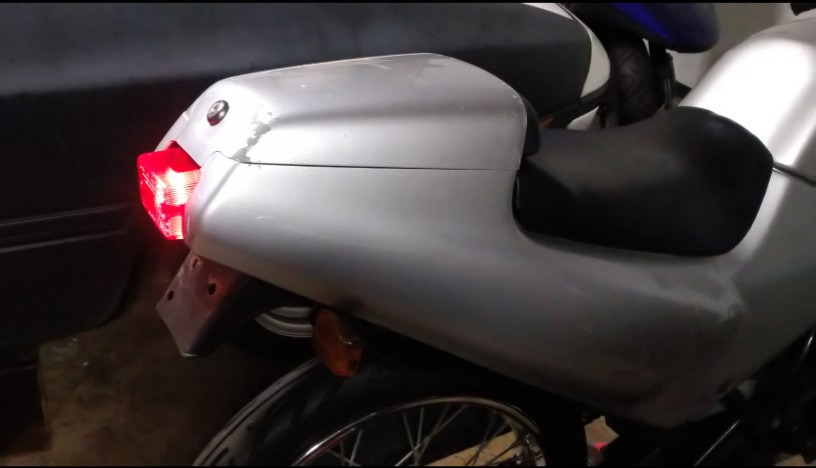

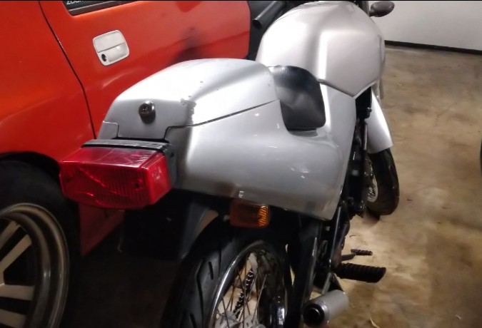

Rare JDM goodie!!
Before
After

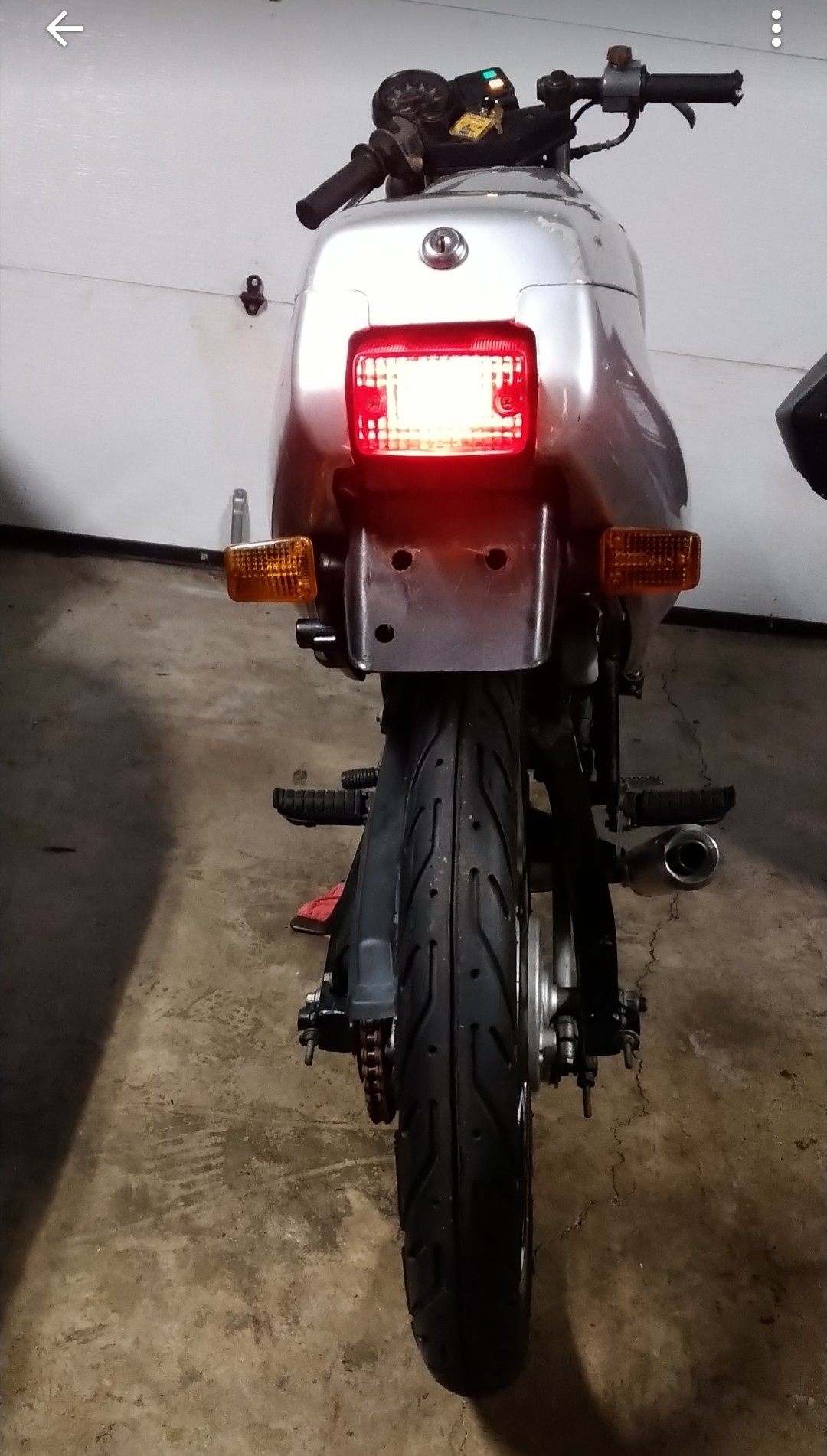

Hey guys and gals, I just managed to make a deal where I'm picking up an ns50 next weekend on a trade. Driving 17 hour round trip for it! I know parts for these are few and far between, but I thought I'd check here to see if I could get any advice on where I might find decals (as you can see it's missing the rear set,) and MAYBE even the radiator cowl? Many thanks in advance!
-Chris
