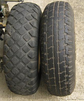

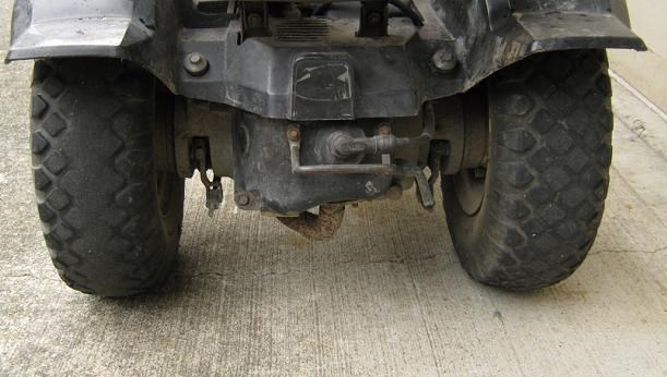

Re: Gyro - general thread
I think the size 5.30/4.50-6 used to fit under the fenders. But have no experience with current tires.
Edit - ignore the following old tire pics with same tire size. Geez - 10 years ago photos :)

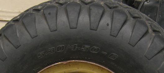

I used tires like the ones you found at tractor supply. They fit fine. Of course, they are turf tires, not DOT approved road tires, and they probably won't last long or grip very well. At the speeds I ride the Gyro I'm willing to take a chance on them. It seems unlikely that they will blow out at 20 to 25 mph, and if they do I'm prepared to deal with it. They may be Carlisle brand.
Here's a Carlisle catalog for your reading pleasure: https://carlisletire.s3.amazonaws.com/C ... atalog.pdf

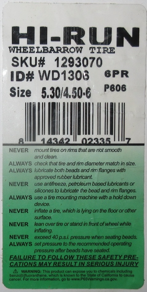

I picked up the sawtooth tires from Tractor Supply just now, and while they don't say Carlisle, they are probably the same. The specs in the Carlisle catalog on page 14 say 6 ply and a max load of 885 pounds at 95 PSI. If you double that for two wheels in the back, I think that means a max load of 1,770 pounds.. The tires I got from Tractor Supply are labeled wheelbarrow tires on the paper label. Large letters on the sidewalls say Hi-Run, so I guess that would be the brand. The sidewalls also say "Not for highway use" and weight limit is 695 pounds at 54 PSI. I know I am a bit overweight, but whichever the spec, they should be beefy enough. I also ordered the 2 ply Cheng Shin knobby tires and they are due here tomorrow. I'll have a look at them and then decide Friday which set to try. Here is the paper sticker on the tires from Tractor Supply:

Hi-Run Wheelbarrow: 6 ply, tubeless, max weight 885 and 95 PSI, not approved for highway use.
