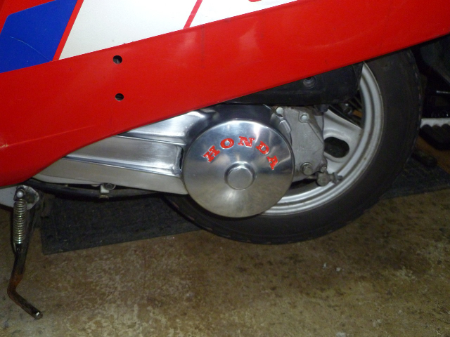

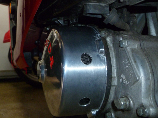

heres some pics of my polished tranny cover, today i found out what was up with my take off, somehow grease got slung on the pads and bell. so i cleaned it of and cross hatched the bell with some sandpaper for extra grip and it now takes off way better, and then i added a forced air induction vents to keep the clutch cool.(notice the window screening i installed to keep crud out) but i will have to taker it on a long ride to see if it helps, also yesterday i got the ol aero up to a GPS verified 50mph! downhill... and 42mph+ on the flat but i think i could go faster on a smoother road
