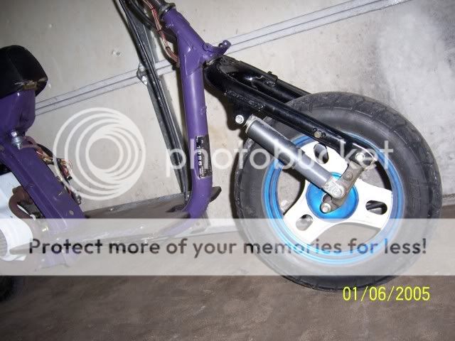

Like this?Petrock's 1984 Spree wrote:Turns out they did have the front forks and front wheel of the Elite laying around so i snatched it up for cheap![]()
The Elite whell definately does not fit in the Spree forks so im looking into swapping the forks as well
I know the forum member Levi has done this but he hasnt been on in a while and was wondering if anyone else has done something similar and how difficult it is
Thanks
- Petrock's 1984 Spree

Yeah I just foud that with the search a few minutes ago
How do you go about doing that?
