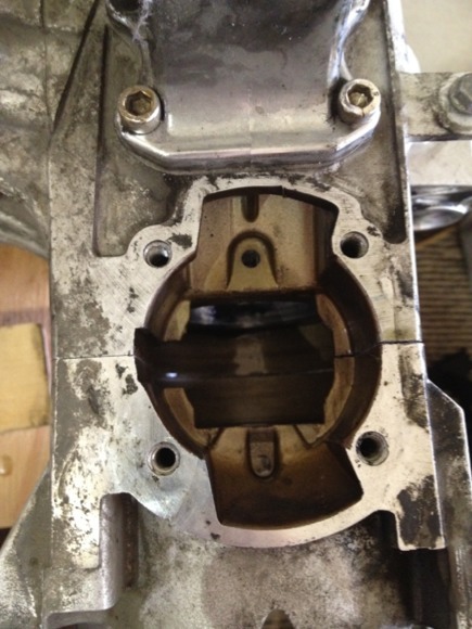

The sym block has almost no boost port.

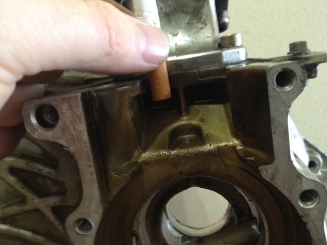

And the intake is really small, put a cigarette there for comparison.

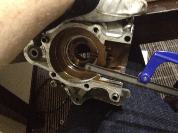

Started the boost port!! Using a hacksaw blade to start and will finish with a file.

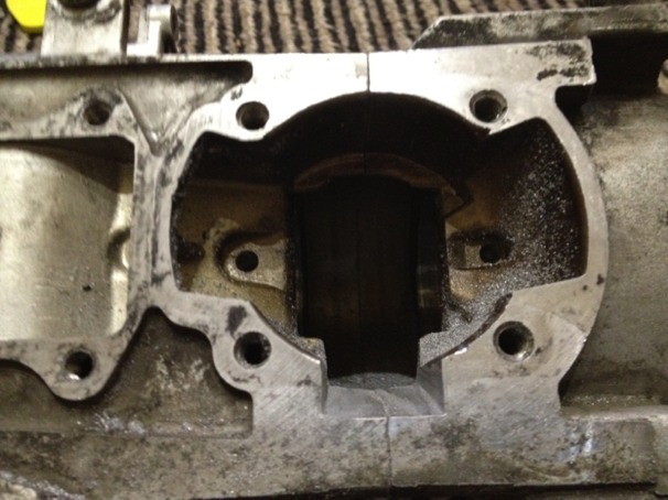

Big difference!!

Almost done with file!

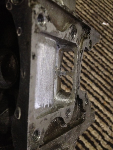

Not the best job on the intake but it will do as I don't really have the right tools for this part!

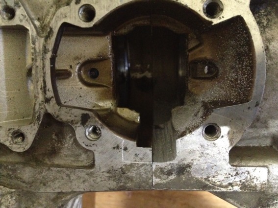

And some shots of my work done today!

Wow huge boost port..! Nice work bro.. Looks really good
