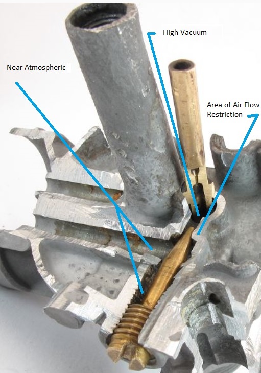

-- Air leak at air screw threads causes no change in mixture --
The needle/seat sets the flow rate. High vacuum side is on the side which flows into the carb.
Air screw threads are on the weak side of the vacuum. It is near atmospheric pressure at the shaft and threads. So not much air flows there, and what does will not impact the needle setting.
between the spring and the carb body
That is where the later models placed the o-ring

I think you'll need some good welding skills to repair your carb now that you've cut it open to show me!
Thanks for your feedback.
So, no point in getting a headache with the supposed air leaks on the air screw threads.
My problem seems to be elsewhere.
