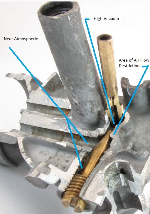

Re: New member from France with a 1986 Aero 50
Posted: Tue Mar 18, 2014 3:38 pm
Should I put an oring on?
I was wondering how air could avoid entering by the threads of the air screw and falsing my settings...
-- Air leak at air screw threads causes no change in mixture --
The needle/seat sets the flow rate. High vacuum side is on the side which flows into the carb.
Air screw threads are on the weak side of the vacuum. It is near atmospheric pressure at the shaft and threads. So not much air flows there, and what does will not impact the needle setting.
between the spring and the carb body
That is where the later models placed the o-ring
Posted: Tue Mar 18, 2014 4:06 pm
by GSX1400
I think you'll need some good welding skills to repair your carb now that you've cut it open to show me!
