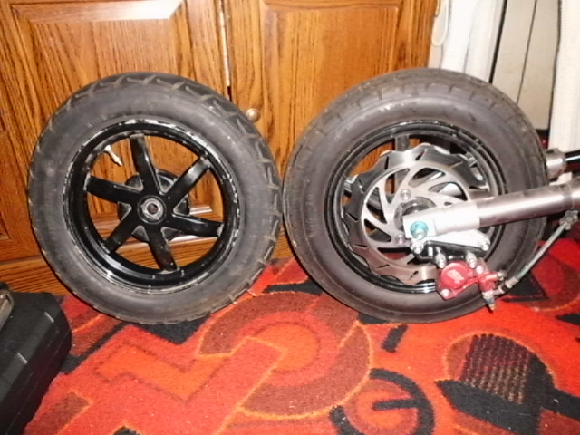

picked up disc brake parts forks and rims
Edit
from page 6
metro rear wheel 8 pounds 12 ounces
stock elite rear wheel 8 pounds 7 ounces
dio rear wheel 7 pounds 11 ounces
Last edited by cruzingratiot on Mon Feb 24, 2014 12:33 pm, edited 1 time in total.

Nice, how much were they and where did you find them? Thatll help stop that beast!

Love those dio alloys. I've got a set. Were do you get that large disk brake kit from?

LoveMyHonda wrote:Nice, how much were they and where did you find them? Thatll help stop that beast!
NZHonda wrote:Love those dio alloys. I've got a set. Were do you get that large disk brake kit from?
it was on the parts bike
me and my friends drove to Indiana end of last summer and bought it a parts bike really cheap
than down to Indianapolis for a 1 owner elite 520 orig miles
never registered by the original owner stull had the Certificate of Origin and original bill of sale
original cost $1699.00 +89.95 tax will need to start a thread on this one
I probally paid more for food and gas than for the parts bike
the parts bike and the 2001 elite was originally bought by a friend of mine
than he decided to sell them to me this winter
more on this bike in another thread

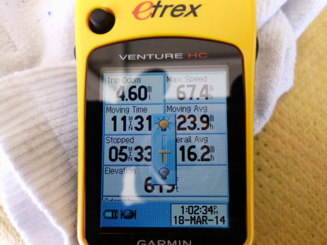

run run arrow pipe( pilot jet 45) mainjet 120 variator 33.6 gram
67.4 mph getting better
93 Octane fuel , (R+M)/2.
8.5 gears
24mm Polini carb 118 main jet 45 pilot jet
yellow contra spring 1500 RPM
polini variator 33.6 grams
temp 40 deg F
CHT max hit 355 deg
67.4 mph
arrow copy pipe
oko air box
polini corsa 72cc
malossi crank
32-1 premix Klotz r-50
Metzeler ME 1 Tire (3.00-10)
ordered rpm gage < need this
and 128 / 125 jet <had a 125 but ?
there were a couple of other runs
but this is what I remembered
the pipe has good pull through crusing speeds
hopefully with more tuning I can go faster than my 70 mph run
more to come

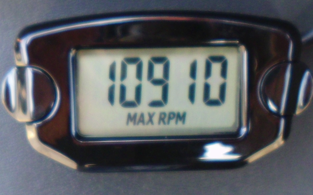

( pilot jet 45) mainjet 115 variator 33.6 gram
clutch grabs at app 4800-5000
hit 10,910 rpm
no gps with me
everything else the same
was just going for a joy ride
than someone on a moped pulled up next to me
he lost
realized it is stull rich messed with jetting
wound up with a 40 pilot
and a 110 main took it for a short ride was running better
more testing when I get more time
