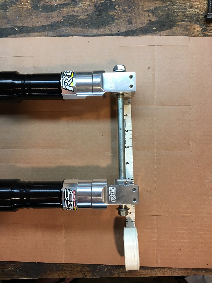

Dry fitting the parts tonight… I found out a metro stem is too narrow for a NCY front wheel so I am going to give the NCY stem a try. It is right in between the Metro and Ruckus, this is what I found.
All measurements are center to center on the legs.
Metro 6-1/8” EDITED!
NCY Elite 6-1/8” EDITED!
Ruckus 7-1/8”

ntonar wrote: Wed Feb 06, 2019 9:16 pm Dry fitting the parts tonight… I found out a metro stem is too narrow for a NCY front wheel so I am going to give the NCY stem a try. It is right in between the Metro and Ruckus, this is what I found.
Metro 5-1/16”
NCY Elite 6-1/4”
Ruckus 7-1/8”
:shock: I'm pretty sure I have a metro stem that is the same width as the NCY elite stem. Your NCY is over an inch wider? :surprise: I will check again to be sure

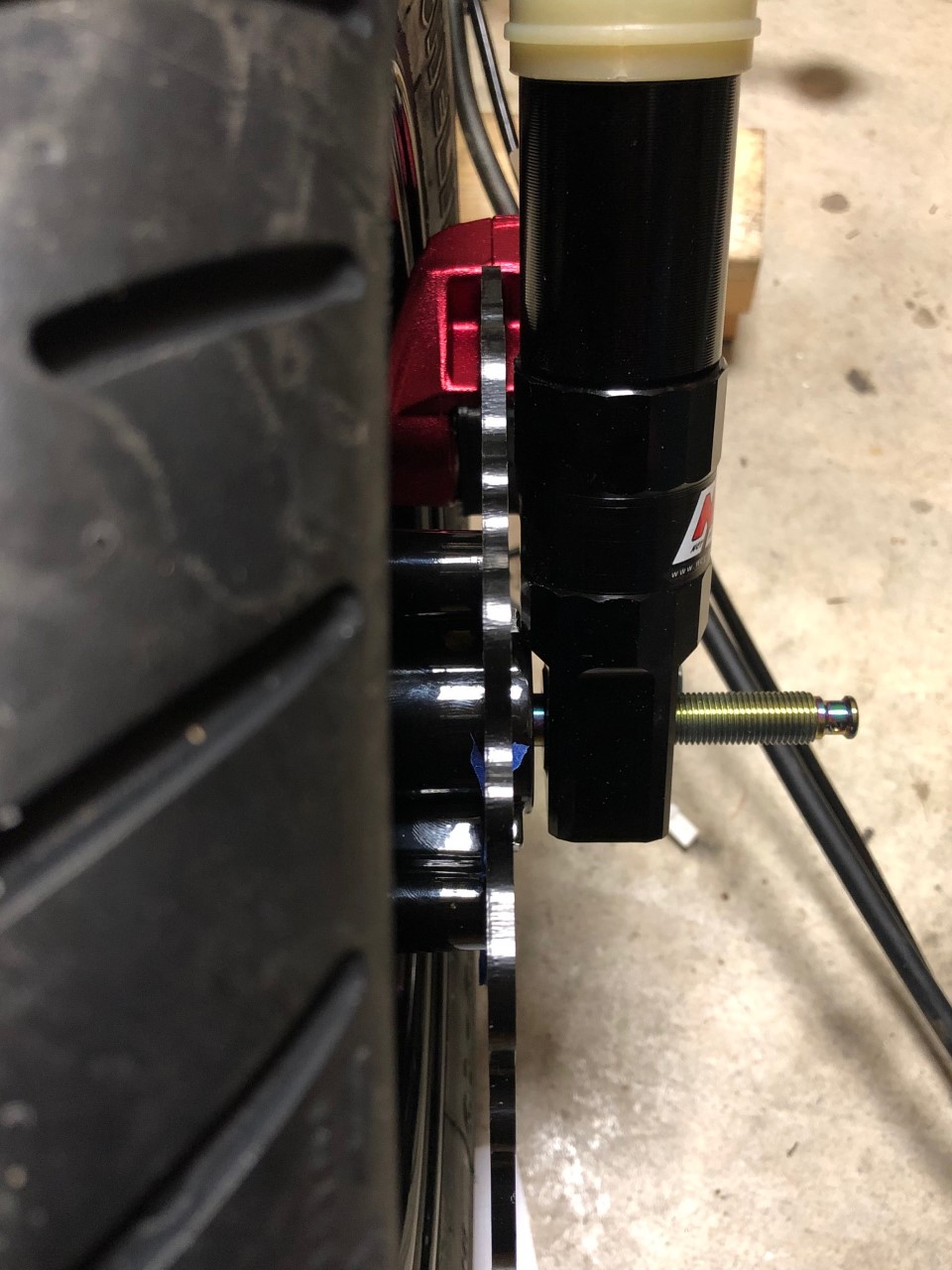

Thank you for the photos, looks like the metro and NCY measure the same. Back to the drawing board, Below is a print with the dimensions of the wheel setup. You can see my rotor is going into the leg .09in. I either need a wider triple or move the rotor in towards the wheel but might run into caliper clearance.

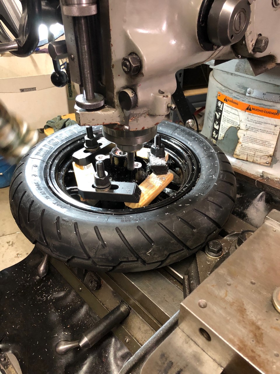

After some time mocking the wheel up I found out it will fit with some modifications. I need to mill some material off the rotor mounting surface and I will be in business.

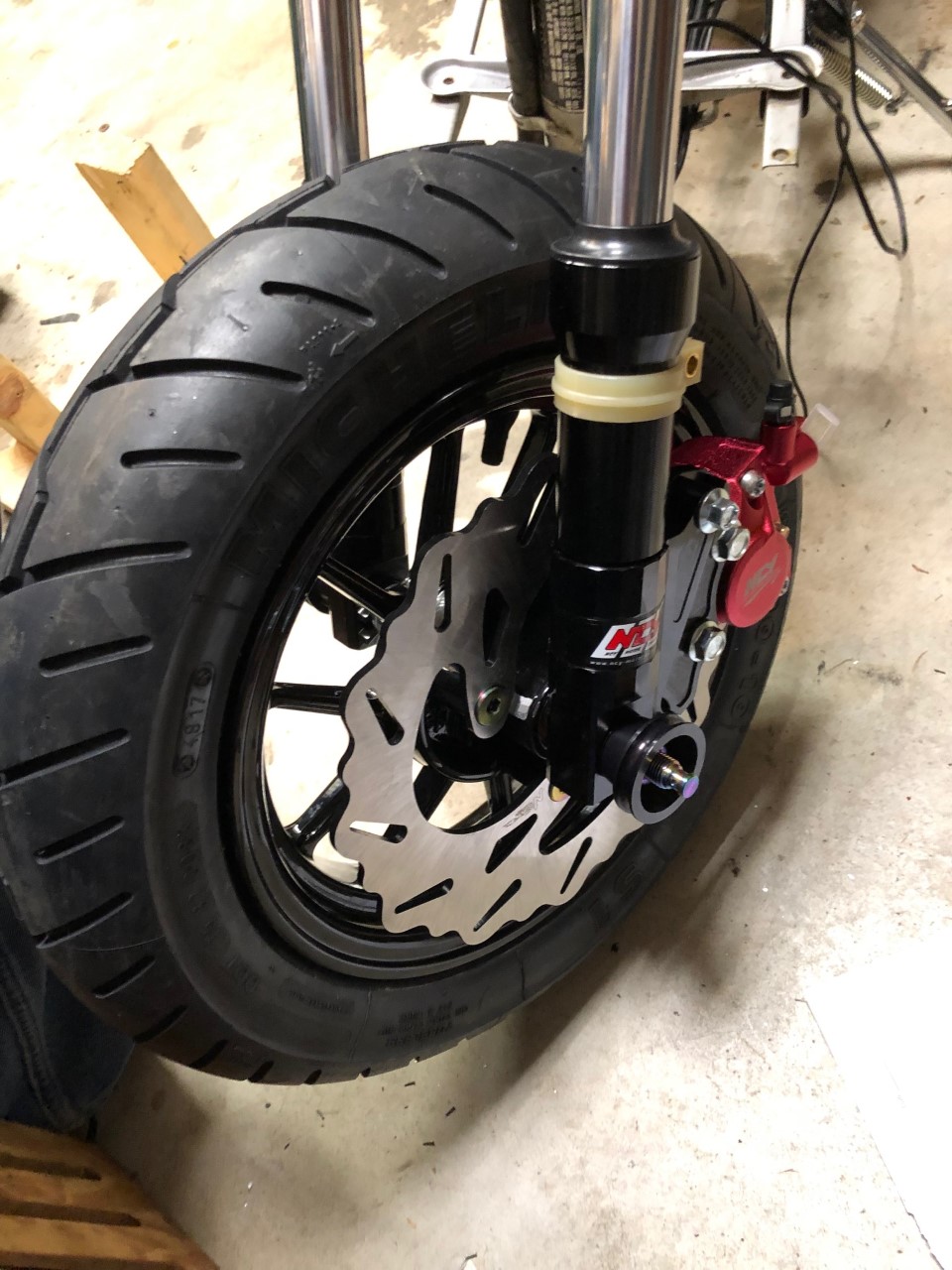

It fits! I ended up milling 0.180" off the rotor mounting face. It's a tight fit but happy I didn't have to go with the Ruckus stem.
