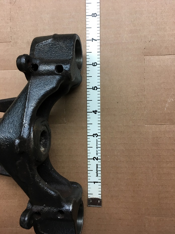

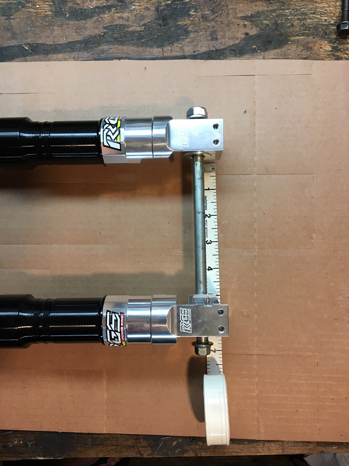

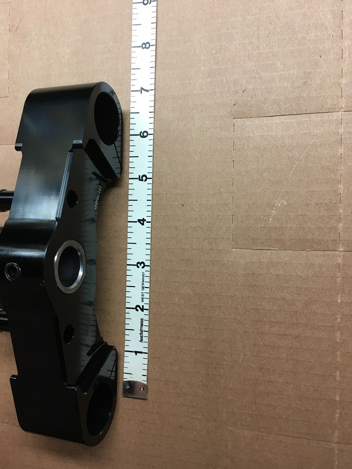

Dry fitting the parts tonight… I found out a metro stem is too narrow for a NCY front wheel so I am going to give the NCY stem a try. It is right in between the Metro and Ruckus, this is what I found.
All measurements are center to center on the legs.
Metro 6-1/8” EDITED!
NCY Elite 6-1/8” EDITED!
Ruckus 7-1/8”

ntonar wrote: Wed Feb 06, 2019 9:16 pm Dry fitting the parts tonight… I found out a metro stem is too narrow for a NCY front wheel so I am going to give the NCY stem a try. It is right in between the Metro and Ruckus, this is what I found.
Metro 5-1/16”
NCY Elite 6-1/4”
Ruckus 7-1/8”
:shock: I'm pretty sure I have a metro stem that is the same width as the NCY elite stem. Your NCY is over an inch wider? :surprise: I will check again to be sure

I don't have it yet but that is what SSS measured.

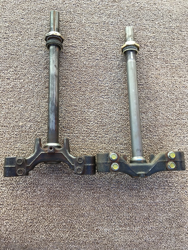

Re: Just another AF16 Spree Swap
Posted: Thu Feb 07, 2019 9:03 pm
by bonesv
124 copy.jpg (228.84 KiB) Viewed 30075 times
123 copy.jpg (257.73 KiB) Viewed 30075 times
Posted: Fri Feb 08, 2019 9:19 am
by ntonar

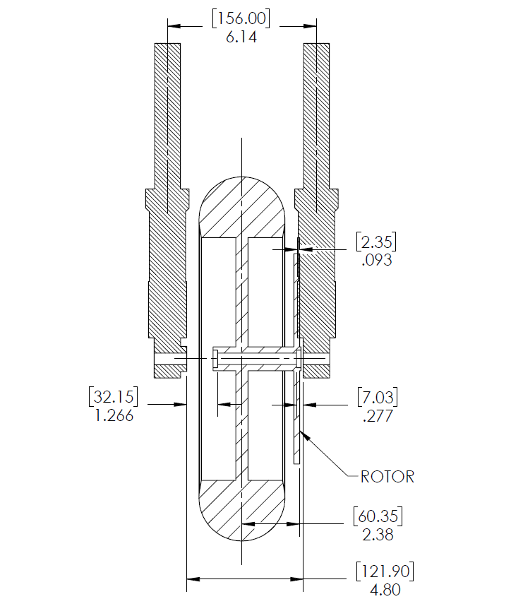

Thank you for the photos, looks like the metro and NCY measure the same. Back to the drawing board, Below is a print with the dimensions of the wheel setup. You can see my rotor is going into the leg .09in. I either need a wider triple or move the rotor in towards the wheel but might run into caliper clearance.

:thumbwink: Some aftermarket rotors/forks require some clearance grinding of the fork body. Especially a floating-type rotor. I have personally had to do minimal clearance grinding on oem style forks for a rotor to fit correctly and have not had any adverse consequences. Even with the ruckus stem you may have to grind to achieve the proper alignment for the rotor to spin freely without binding in the caliper. According to my estimation, the fork to wheel distance would not change by switching the stems alone. Possibly some shims could be used to adjust distance of caliper from the fork if you used a ruckus stem and spaced it accordingly? Ultimately, you would want the wheel to mount in the center of the stem for riding straight. I hope this can help you find your solution!

After some time mocking the wheel up I found out it will fit with some modifications. I need to mill some material off the rotor mounting surface and I will be in business.

Nice work! I just hope the caliper clears the rim of the wheel..... If you find that the ncy legs are still not short enough, you can use a dio zx (af28 or af35) stem. It is same as the metro stem except the lower tree is kinda upside down....making the wheel ride closer up to the frame by an inch and a half +, and the bearing race is the same as an Elite sa50
247 copy.jpg (454.27 KiB) Viewed 30022 times

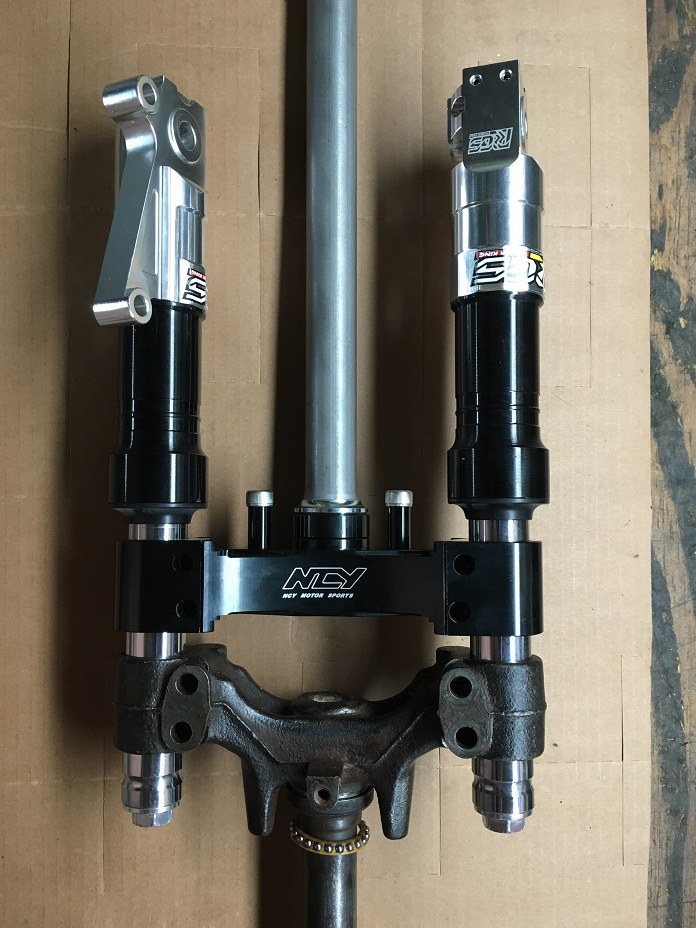

It fits! I ended up milling 0.180" off the rotor mounting face. It's a tight fit but happy I didn't have to go with the Ruckus stem.

Pics that didn't attach....

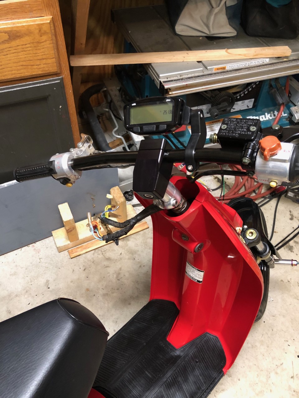

I think the front is pretty much done (still waiting on a headlight), I still have some small items to finish up. In the other news it warned up a bit, so I could got for a quick ride and finally take her out of the garage for a photo.
