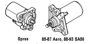

does any one know if any other starters fit the nq 50 like the sa for example

The Spree starter mounting plate is different than all SA50 and Aero models. Early Aeros are much different. SB50 has a stamped steel mounting plate.
I'd stick with the Spree starter. Internal parts exchange is possible with some, but the Spree is the common and low cost starter.

Anyone else tried looking at other scooters and small cycles for a Mitsuba starter equivalent? I spent some time looking at various Japanese scooters, cycles and ATV's for equivalents. Only starters found are the knock offs for the 88-93 SA50 on eBay.
