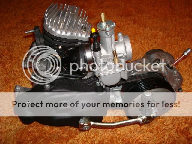

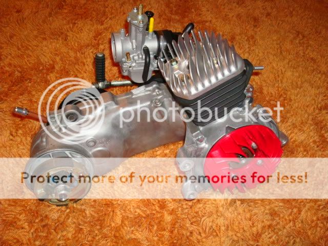

These are some pics of my AF16 when I recently installed my new full-counterweight SEF "mini stroke" crank... Hopefully the AF16 wont leak anything on the orange shag
-No wait... I built the motor so no leaks!! Haha!! :bowrofl:
Check out the new KOSO intake manifold. (its the small version) I added Stage 6 reed block which includes carbon fiber reeds by Moto Tassani.
Now the engine is back in the Aero and is running great... just waiting for a good day w'out rain to take a ride!

does it bolt up to the aero mount or did u have to modify it. a noob on engine swaps

:thumbsup: Toast, i have always noticed that your builds are exactly like mine - you strip everything and clean meticulously. It's a pain in the a**, and as you know your hands and fingernails never *really* get clean again... but the end results are worth it. -when i got my AF16 cases i should have taken pics of them to show what they looked like before. They were stained and caked w' 2 stroke "grime."
tw: the AF16 Elite engine is not a direct bolt-in, but it's very easy and straightforward. -i used an '87 SE50 engine mount, and although the engine wiring harness is different, with some electrical connectors it becomes plug and play.

z50r-blank wrote::thumbsup: Toast, i have always noticed that your builds are exactly like mine - you strip everything and clean meticulously. It's a pain in the a**, and as you know your hands and fingernails never *really* get clean again... but the end results are worth it. -when i got my AF16 cases i should have taken pics of them to show what they looked like before. They were stained and caked w' 2 stroke "grime."
Thanks, mousewheels! -yeah, my Aero now pretty much lives in our living room!! :mrgreen:
later guys, jon
are you saying that it IS a bolt on affair WITH the SE mount... or...?

cuz i have a 87 elite and a 87 aero kinda looking to do a af16 in the future

Mookie, you have to use a different engine mount because the NB50 Aero engine mount is staggered and if you used the NB50 mount the AF16 engine would be too far to the left or right.
-An AF16 engine mount will work perfectly as well as the SE50 engine mount. I know all you have to do if you have the SE50 engine mount is used is to use 2 belt cover dowel pins slid over the engine mount bolt because the SE50 engine mount uses a larger diameter bolt than the NB50. -The dowel pins fit perfectly and corrects the diameter difference.
tw,
you can cut down and shim with washers the NB50 engine mount, but it's much easier to buy an AF16 or SE50 engine mount and just bolt it up...
Wheelman, your post always make me laugh my butt off. Good stuff indeed... I will do a comparison with the CT and the Koso mani and let you know what I find out...
