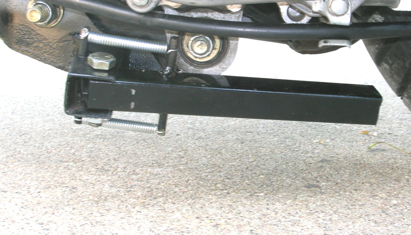

as simple as the centerstand is i do get tired of dragging a scoot up on one .so i converted an old engine mount style sidestand cradle frorm a mid 80's dirt bike today shoulda took pics and note but i didn't wanna break the mood...

it only took me nearly ALL day Sunday to do it,(one trip to Lowes for steel)!!
the whole time i was making it i'd tell myself-"you should be taking pics,you should be taking pics,you should be taking pics..."
i can find /send you the appropriate hanger.
looks similar to this reject:
requires only two hole drilled-
through the main frame tube !
the one i used the stand length was perfect, lop off the footpegs and holders
and use the 4 holes to weld steel strips to and then blah blah.
mines somewhat over engineered for it's intended purpose- to hold up a scooter-NOT a rider.although it prolly would.
will work on any scoot without a plastic under pan.
promise you wont laugh at my welds and i'll take the board off and shoot some pics?

Those welds look great. The brackets are pretty thick considering the thickness of the parts you are attaching to.

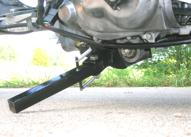

Edit here is my version of a side stand. Lightweight and strong.
It had a couple of sections of square tubing of 3/4" and 1" and some 5 mm round rod. I thought perfect. I figured the flat part of the frame was a good spot to weld to.
Well it took a couple of hours to make it work. I may put a foot on it and a wire to help reach it more easily.
It has 50 degrees at least of static lean angle before the bracket hits.
Here it is with the baseplate on it
1989 Elite E with 86cc Dio
Re: SIde stand added
I don't know what you were embarassed about. Pro-looking to me, dude, but I agree with EliteDio: Way strong! Nyloc nuts, too. Are you planning to prop up the entire cast of Cirque du Soleil?
You're brave to drill the frame but if those frame holes are completely tight-filled by bolt material, there shouldn't be much/any strength loss in the main frame spar. This is offset by the thick brackets spanning the holes. Except for hiding the VIN sticker from the prying eyes of the Authorities, an enviable job.

elitedio wrote:Those welds look great. The brackets are pretty thick considering the thickness of the parts you are attaching to.
i added bracing to the top side as well so it's kinda two thick pieces sandwiched with a thin
layer in between.call it mustard on rye bread... :ndance:

mookie wrote:i added bracing to the top side as well so it's kinda two thick pieces sandwiched with a thin
:D :D Thanks for the pics, Build - not - buy! 8)

dude, that sidestand setup looks great! :worship: -your design is probably 20 times stronger / more functionally rigid than any of the aftermarket clamp on designs. Welds look good, too. Awesome job, man....
