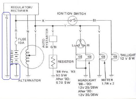

Going back through Surfing's post ---
Headlight blown & replaced --> Blew again!
Taillight replaced, will blow if rpms are up
I think mr portable's ground check idea is a great place to start. Your failures are on two different regulator pins - Headlight is on the AC stator, while the tail lamp is on the battery side of the regulator. Check ground closely at the regulator itself and ground as well as the battery path to ground.
- Elite_Regulator.JPG (22.5 KiB) Viewed 4974 times
