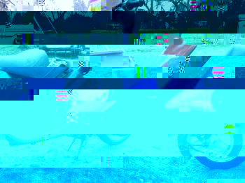

Ok I bought this 87 Elite. The clutch was blown and the front wheel was bent, he wanted $40 for it so.... I bought it.
So I got a clutch from VT Cycles and installed it. I thought I want to hear this thing run! so I stole my battery from my 86 Spree and threw it in. the starter would turn but only about 1 revolution. then would only go TICK. If I turn back the bendix gear it would turn again just the same. Also once I reinstalled the cover with the kick start I couldn't push it down. I got scared and thought seized motor. so I pulled the kick cover back off and turned the gear where the starter connects by hand and I could turn it! YEA! (I hope) So.... If any of you have any suggestions on WT@#$!! is wrong with it PLEASE HELP!!! I don't know if my battery had a full charge or if it has enough juice to turn over an Elite but.... Once I reinstalled my battery in the Spree it wouldn't start. So I kicked it and let it run until it would start again. Although I really tried alot on the Elite and may have drained it partially. Batttery should be in good condition I bought it new in October. PLEASE HELP!!!!

Why can't you kick start the elite? Get that fixed.
Charge the battery with a charger less than 2 amps then try again.

Is the gasket for the cover missing or messed up? Sounds like cover is causing binding. Been there.martynkim wrote:Ok I bought this 87 Elite. The clutch was blown and the front wheel was bent, he wanted $40 for it so.... I bought it. starter would turn but only about 1 revolution. then would only go TICK. If I turn back the bendix gear it would turn again just the same. Also once I reinstalled the cover with the kick start I couldn't push it down. I got scared and thought seized motor. so I pulled the kick cover back off and turned the gear where the starter connects by hand and I could turn it!

Gasket is not messed up looks fine. I know I messed around moving the gear for the kickstart along as the spring I'm gonna try and match the the pictures
Re: PLEASE HELP!!!!
Yeah, get the kick-start mechanism working first, can you move the kick lever by hand with cover off?

I can move the kick on the cover. I'm not sure hoe it eorkd on the bike.
