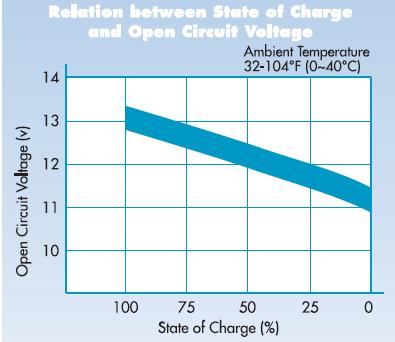

LocoParaHonda wrote:But I checked the battery level and while the moped is off it's steady around 12v. While idling and running the blinker it creeps down to 10-11v but that's about it.
So the battery seems pretty normal, I'm thinking maybe I should try replacing the blinker relay.
If you are up for some more testing:
1) How well does your electric start crank? I recall you added a kick start to that '85 Aero, don't know if the electric starter gets used any more...
2) Lead acid battery voltage needs the decimal point. A fully charged battery is around 13.2 v. If you are measuring is close to 12.0, then the battery needs charging.
3) It's been awhile since I've measured a flasher relay, but recall that *not* flashing at 10 or so volts is what a good one does.
4) If you scooter has been sitting, or your charge circuit is not working as it should, 7 months is long enough for a good battery to self discharge quite a bit. Quick check on the charge system - start and rev up. Battery voltage should be well over 13.8v, more like 14.2 or more.

You were all right. It was the battery. I had just assumed since it was called a 12 volt battery that 12v was what the ideal voltage was. I didn't know it should be more like 14v. I set it up on the trickle charger for most of the day today till it read 14v and now everything works fine.
