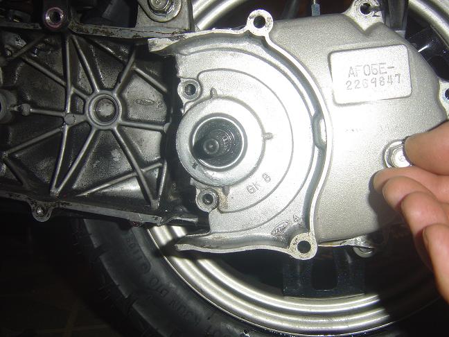

i used this
11. carefully replace the gear cover like so.

i used this
[Pic of transmission case cover nicely prepped with Permatex.]
Since there have been a couple of posts describing "Whirring" after the upgear installation, this may provide the reason. Y'see the gasket isn't just for sealin'. Its thickness is calculated into the final assembly of these high-precision parts. Permatex may do an admirable job of holding the oil in the cavity. However when you tighten down the cover bolts, it crushes down to nearly-nothing. That ~mm of gasket thickness is gone, so there is a good chance that the countershaft will be pinched end-to-end. A similar issue regarding the starter Bendix arose about a year ago: You can't install the belt cover without either a gasket or some shimmage to prevent the same shaft-pinching issue there.
Check that transmission countershaft and axle shaft for signs of heat-darkening. Also check the cover and the crankcase side to see if the gears have shaved off some aluminum.
If the gasket really has been discontinued by Honda, a better solution would be to make one out of Autoparts gasket material. I'll bet that doing so resolves the noise issue. Slathering both sides of your new Honda or Homemade gasket increases the odds that you'll be able to re-use if you ever must disassemble again.
