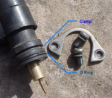

Posted: Sat Apr 03, 2010 10:48 pm
Photo of a partially assembled clamp and bystarter.

by CharlotteSpreeRider
Dear god, man. Push that bystarter in there proper, twist it if you have to, another 1/8 inch or so. No screw threads should be visible. The metal bracket goes on the uppermost bit on the bystarter body, you're leaking air and running lean! Fix yesterday!
The screws were intentionally loosened, and the bystarter pulled up to give the partially assembled view. It was supposed to make clear which slot the clamp goes.

Actually, mine kind of looks like that anyway. I'll try to get a pic tomorrow. I believe the section facing the camera in that picture is lower on my carb.

CharlotteSpreeRider wrote:Dear god, man. Push that bystarter in there proper, twist it if you have to, another 1/8 inch or so. No screw threads should be visible. The metal bracket goes on the uppermost bit on the bystarter body, you're leaking air and running lean! Fix yesterday!
Wait, does the clamp go like in the picture (middle spot) or "on the uppermost bit"?
Just like the picture, here's a fully disassembled view showing it too.

Sorry for the poor cell pictures but here are shots of where the bystarter sits in. See how the screw locations are above the lower rim causing the oring not to seal at the bottom?
I got it running pretty good last night with no air restrictions but the fuel/air screw all the way in. Plug looked pretty good in color as well.

Thanks for the pic.
Mmy apologies - The Spree does look to mount the bystarter with the clamp at the top. I used to have a carb around to check those details :oops: The carb in the pic is from a later model Honda. We need to have two photos around for the clamp!
Does it seat correctly with the clamp at the top?

by LawlerClan
It does seat correctly with the clamp at the top. I may switch it and try it again although with it running now I am somewhat hestitant to mess with it too much more. Guess I'll just write down current settings so I can go back.
