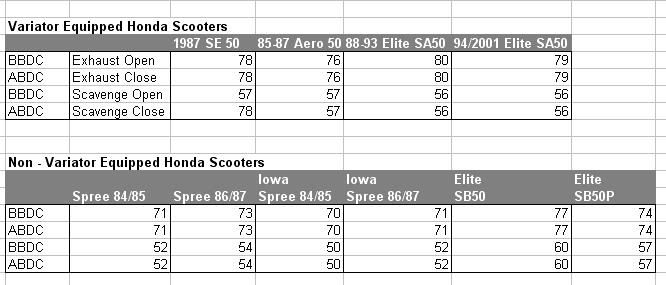

Re: BBK questions
Here you go.
Re: BBK questions
Correct I have seen this chart.
Do the numbers suggest you could expect better bottom end performance from a 86/87 non Iowa spree jug over an 84 spree jug?
Would the difference be enough to notice a change in the performance or it is so slight you wouldn't even be able to tell?
Re: BBK questions
Actually theory would say the smaller ports of the '84 should make better low end power than the bigger ports of the later motors. But in real life some times the engine combo (carb, intake, reeds and exhaust) just doesn't work that way. If it was me I'd go for later jug, but I skipped the Spree jugs to use an SB50 jug for my Spree.
