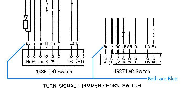

Left Hand Control - 3 Harness/connector iterations : 1984/1985 <> 1986 <> 1987.

Well The left combination switch will not cross over for 86 -87 completely different wiring.

martynkim wrote:Well The left combination switch will not cross over for 86 -87 completely different wiring.
I just checked the wiring diagram for the 84/85 . It shows a difference from 86 too. Argh - 4 years, 3 versions. Left hand control is a good one to watch out for. I yet haven't checked, but possibly guys can splice the wires *if all else is compatible*.

Well, If you have time Mouse. Please check if wires can be spliced this is the problem I'm facing right now. :nervous:
Posts: 3485
Re: Request for input - Parts Spree 84/85 vs 86/87 and SB50
martynkim wrote:Please check if wires can be spliced this is the problem I'm facing right now.
I chased the wires around to the bulbs etc. Everything looks ok, just cut/match the wires. Take a look at the wiring diagram and double check. I can't tell where Honda spliced some of the wires which "T" to other locations in the diagram. It's likely safest to cut/splice the wires close to the left control rather than the other end.
Anyhow by the time you get physically right up for the left control - the wires will be just 1:1 color match and splice.

Double check this - The high beam wire shows a different letter code 'Bu' vs "Bl' but I think its blue for both. Not Black which is the color for switched +12v.
martynkim
Posts: 2377
Location: Tacoma, Washington
Post by martynkim »
Ok Cool Thanks Mouse! I'll give it a shot. Low resistance so butt connectors should work? :worship:
Posts: 3485
Sure - butt splices will do fine.
I solder/heatshrink everything because it's mousewheels fun :lol:
