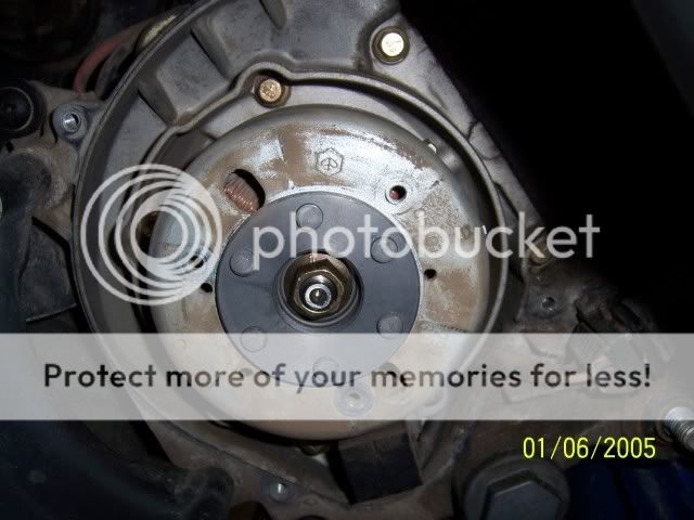

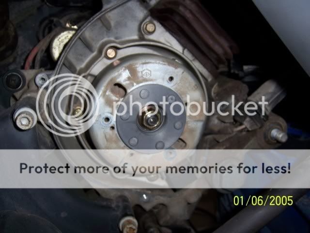

I have no reference to check timing. This is not a cheap chineesy, but it is built just like one.mustangwagz wrote:Get me the motor model number if possible. ill look up the china specs on the valves. its worth a shot. 9 outta 10 of these china made motors has valve issues. Its got spark AND if you put fuel in it manually, it should fire unless it aint Firing or none of the valves are opening? in my opinion.
Hey how about timing?
There doesn't seem to be any marks on the fly wheel for timing. (just the pickup marks)
Any info on how to check timimg a cheap chineese would be great.

Just some pics of thee piaggio that wont run.
