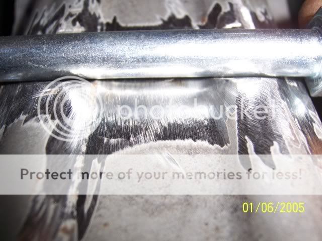

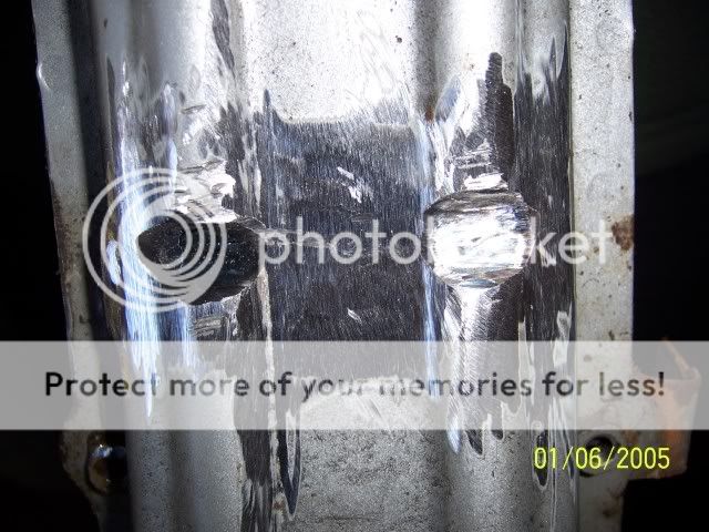

i had already cut down an 87 elite mount, but needed to relocate my shock mount.
one time i landed like this. it hurt.

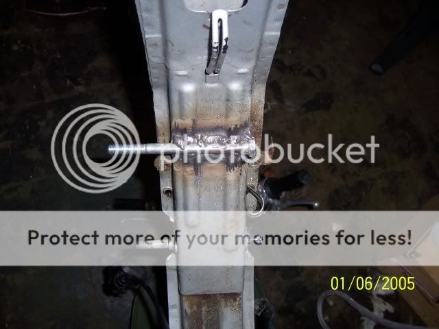

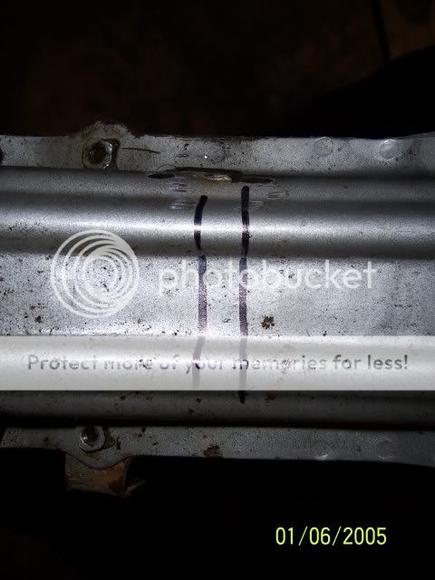

so i marked where the new shock mount was going with my trusty sharpie marker...ImageImage

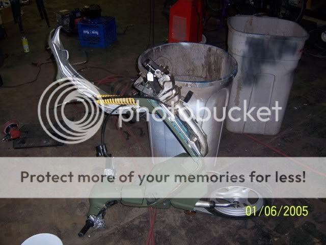

then ground out the reinforcement lump thingamabobbers to accomidate maximum surface area for my weld.
the metal is pretty thin, and it took a little tweaking of settings, so although it's not the prettyist welding ever, i am satisfied that it won't break.Image

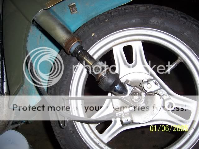

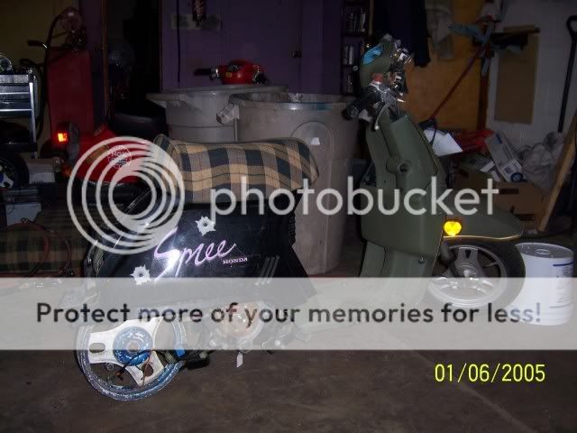

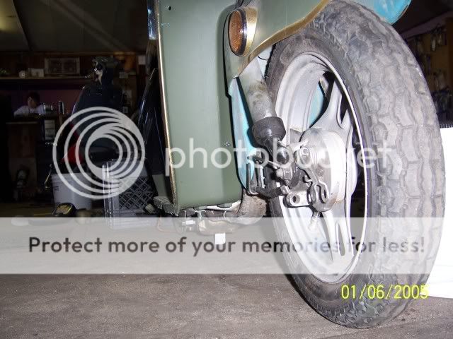

The front now sat higher than the rear, so it was time to slam my spree.

:oops: nobody likes the fruit of my labor?? the weld's not that bad...
Ol' Red
Broken...
Spreeio
1987 Spree
With af16e powah!!!!
Re: spree-dio swap time!!!

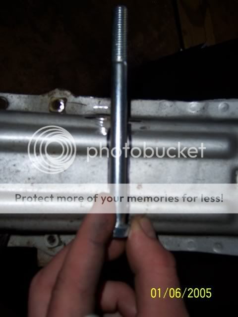

No, a nice job methinks and looks solid. I trust that's some sort of Tempered bolt, not something from The Home o' De Po'?
Spreetard
Posts: 800
Location: Manistee, Mi
Post by Spreetard »
Wheelman-111 wrote:Greetings:
grade 8 :mrgreen: fastenal industrial supply has an outside salesman who i happen to be friends with :mrgreen: :mrgreen:
Ol' Red
Broken...
Spreeio
1987 Spree
In that case when the Pyramids erode to piles of sand that shock mount will still be solid. Well done.

lookin solid indeed, nice job.

Will this be a drag strip only machine? No bounce in the front end wouldn't be much fun off the track.

The rear weld is fine you should be commended on it. Watch out for cracks on the bolt at the nearest weld. I have seen it happen on other similar welds. A better approach might be to weld a heavy tube and slide your bolt through it particularly if you are using a tempered bolt.

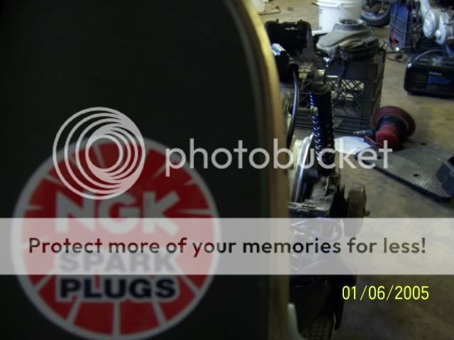

Fishman43 wrote:Very nice.
The front springs can be changed in about 10 minutes with the right tools, and a shock extension will be employed in conjunction with stock springs of i feel like taking it for a trip, but yes, this is mostly a dragstrip/beach toy.
:roll: and it still has some travel, about a quarter inch on the tiny springs intended to keep it from bottoming out :roll:

I'm liking the stance so far :coolcruise:

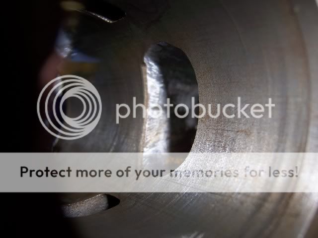

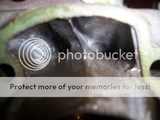

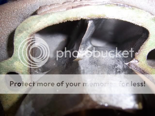

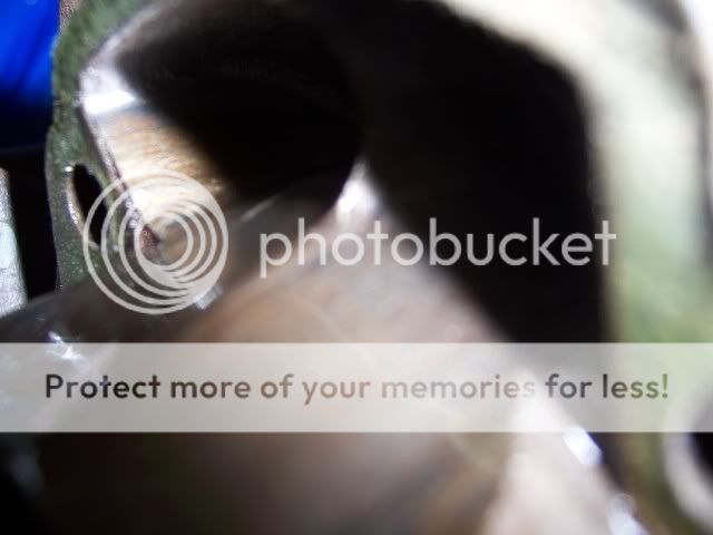

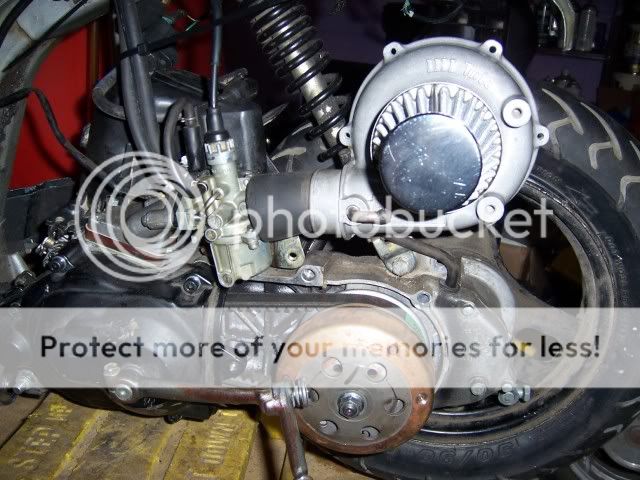

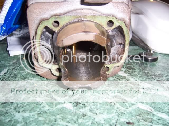

I havn't yet got it all together and running, but here's a few more pics :mrgreen:
Figure 1: the intake ports on my stock bore :ndance:
and the exhaust, through the jug...
Now that...um yeah...custom intake...
