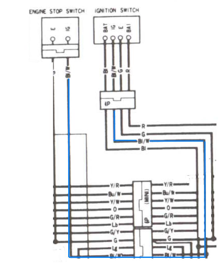

The stock ignition switch had 4 contacts. You should have a double pole, double throw switch (DPDT)
In the "ON" position, the Red (+12v Battery) is connected to the Black wire (+12v switched)
In the "OFF" position, the green wire is connected to the Black/White stripe wire. That kills the engine. Its possible to just leave the Black/White strip wire open and use the RUN/Stop switch on the right control instead. But sooner or later someone might forget to turn off the +12v switch, and drain the battery.
In a stock wired bike, the next step in starting is the brake lever must be pulled, (Gives power to one side of the starter relay coil), and the 'Start' button pressed. That applies ground to the other side of the starter relay coil. Relay coil should be heard to be clicking at this point. If not post back for troubleshooting info.
Also - what color is the 5th wire you have at the ignition? There should only be 4 wires at the ignition switch. Maybe we can figure out what that should tie to.

2 + 2 + 1 = 5 ---> Yes - unless it's me doing the addition. But I did that when I read your posting, and got 5 too. Fact is OEM ignition switch connection has 4 wires. Anyway given the wire color (if that's just a typo and you mean Black/White stripe) I'm inclined to think yours is fine as is. The previous owner probably knew what he was doing.
----- Let's get the wiring diagram out, and talk about this ---
There are two nodes that use the Black wire/ White stripe. Run/Stop switch and ignition. They are wired as an "OR" logic, you can kill the engine by turning the Run/Stop to Stop OR the ignition off.
Now the *factory* wiring as I said only runs 4 wires to the ignition switch. the node that joins the Run/Stop switch and Ignition switch is normally after the ignition switch connector. In your case, it sounds as though the previous owner cut off the connector and performed some wiring of his own. 2 Black/White stripe wires tied to the switch, it's probably fine. If you want you can trace their connection back to the CDI and verify all is ok. But this has nothing to do with the starter not activating.
--- Starter not activating ---
Now if you have enough of the wiring that your brake light will light when the toggle switch is "ON" and the brake is pulled AND you press the start button, there's another problem that needs troubleshooting. Do you have the Brake light working?
--- thanks - mousewheels
