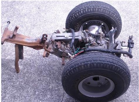

I'm guessing with a basket up front you are talking about a 1984 NN50. They were imported to the US in 1984 only, and are somewhat rare. Price wise - an NN50 sometimes will sell for quite a bit on eBay. Check your local area, and consider posting on eBay if wanting to sell.[
A SA50 engine is much different to the NN50 engine/trans. Unfortunately the SA50 cylinder or aftermarket big bores are not a drop in either.
sell. Photo below is a 1986 TG50, but similar to the NN50 powertrain.
attachment=0]GyroEngine_sm.JPG[/attachment]
